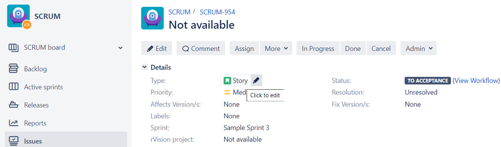

Hi @SUSHANT DUA ,
There is possibility to do it right on the issue view screen:

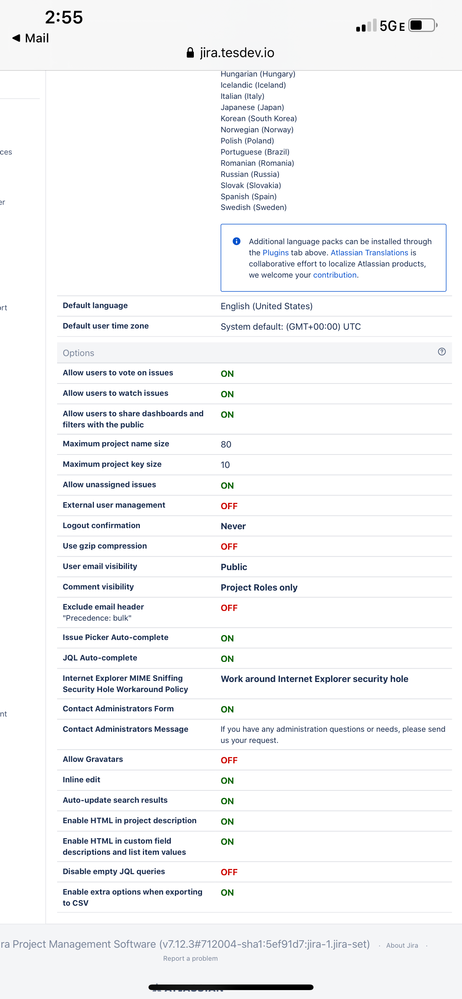

I am super admin and I don’t see this option
Aleksandr Zuevich
October 24, 2019
Check you System - General Configuration - Inline edit option. It should be ON for this.
SUSHANT DUA
October 24, 2019
It’s on
