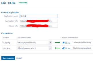

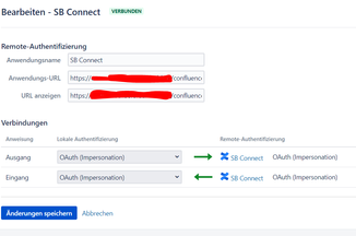

Next step: Application link:
Our settings on the Jira server:
Settings on Confluence server:
