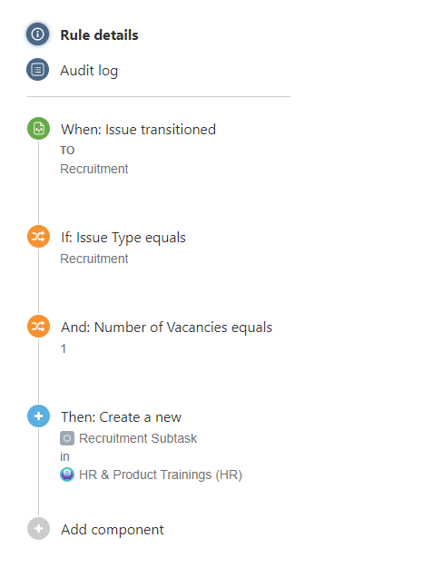

Gor Greyan
May 14, 2024
Gor Greyan
May 14, 2024
Hi Dear @Simon Laffont ,
Automation is triggered when the issue goes to Recruitment status, after that sub-task is created with this automation. I want to copy the Element Connect field from the Recruitment task into the created sub-task.

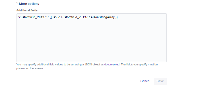

Gor Greyan
May 14, 2024
Hi @Zuri Suwru ,
Tried this, but got the following error.
Error while parsing additional fields. Not valid JSON.

Zuri Suwru
May 14, 2024
Pardon me, I though you were interested in the syntax for the specific field in question. I did not think you need a complete JSON code.
Can you try it like this?
"fields": {
"customfield_20137": "{{parentIssue.customfield_20137.asJsonStringArray}}"
Like Simon Laffont likes this
Gor Greyan
May 14, 2024
Dear @Zuri Suwru ,
Tried also this, and automation succeeded, but the field is not being copied.
