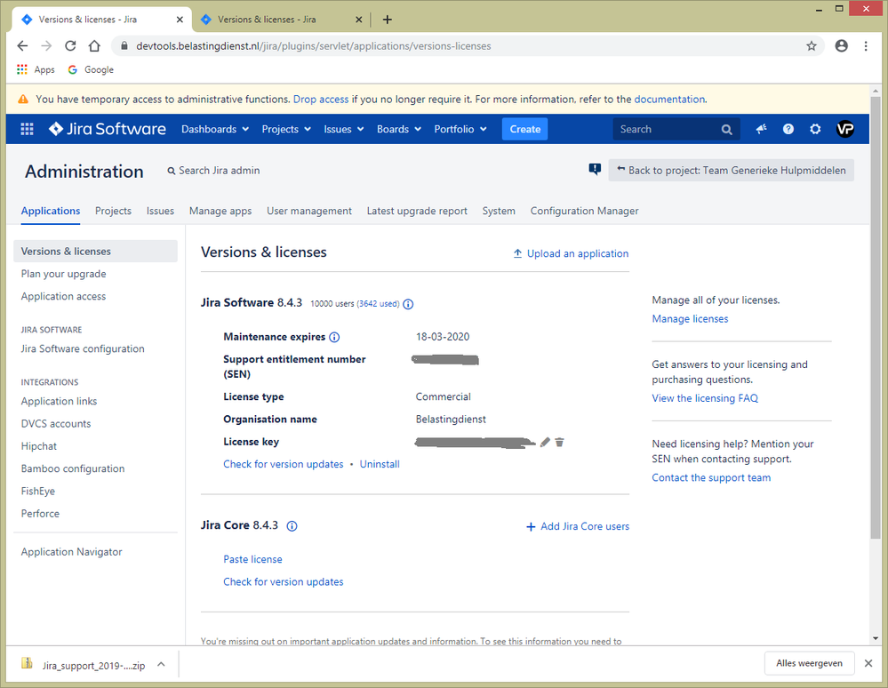

Victor Peters December 3, 2019
As you can see from the screenshot below, the Jira Service Desk application is nog listed under Applications > Versions & Licenses. So there's no pencil or input field related to that application that I could use to enter a license key.
Using the "Upload an application" link on the page should enable me to re-install the application using the *.OBR file. But when I do that I get an error message that refers me to the logs on the server. Due to the large amount of users and the large amount of entries added to the logs each second/minute, it's almost impossible to find the exact log entry/entries that might explain what the error is. To also find of a solution to that error requires more in-depth knowledge of the software than I currently have.
