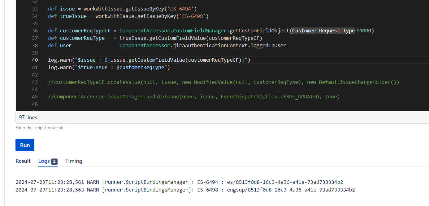

UPD.
The problem is that when I set the field value manually and then retrieve the field value by scriptrunner, I get the value 'es/8513f0d8-16c3-4a36-a41e-73ad733334b2'. But if I take a value from another task and set it in test task, I get the field value 'engsup/8513f0d8-16c3-4a36-a41e-73ad733334b2'. It turns out that the value is broken because of a project key that was changed earlier.
