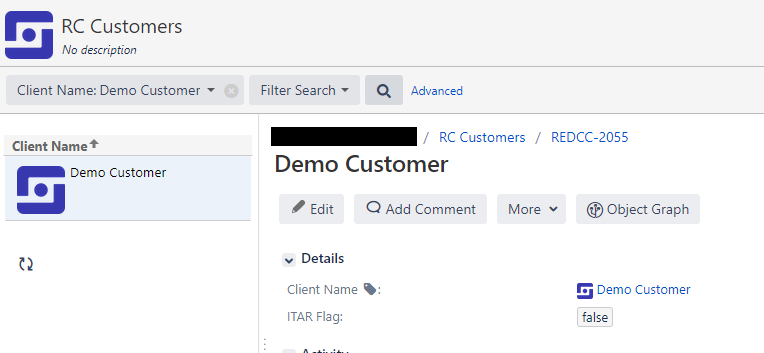

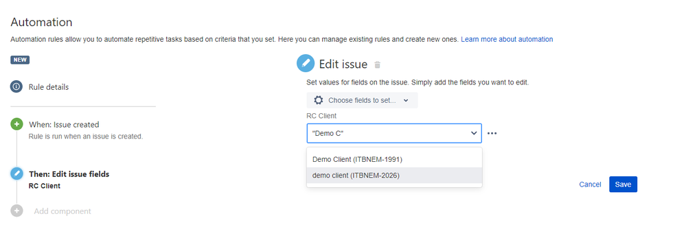

Thanks for your response, I am not using a query, just typing in the name of the object (see attached Fig1).
In Fig2 you can see the object that is not being returned.

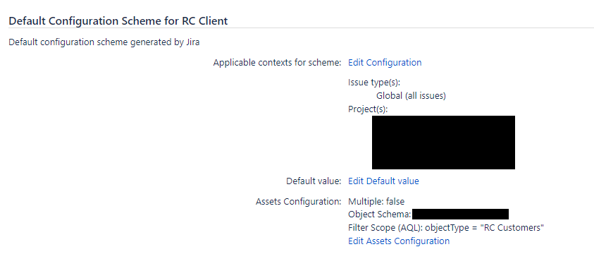

In Fig3 you can see the custom field config for the RC Client field, however I know that this works correctly as I can select the object I want from issues just not in this automation set up.

I would have double checked if the configuration of the asset field to check that it isn't filtered and preventing you from fetching the client object you're after in the automation

Thanks for your response. Yes the configuration of the assets field is correct to include the object I want to select (but is not selectable). please see my reply on previous comment where I have just added screen shots.

If "RC client" is your asset field and you use the edit issue action I think you need to input an properly formatted Asset query in the field value not just the name of the object.
I would have tried NAME IN "Demo Client"  for example, or Key IN ITNEBEM-2026 if you want the automation to always choose one particular object.

Entering a query is not allowed for this option, it is only for selecting an Assets object from the list. You have to type into the box and it returns matches based on the label of the object. Not sure why the objects I want are not being returned but I have raised with Atlassian support and will report back here when I have a resolution.
