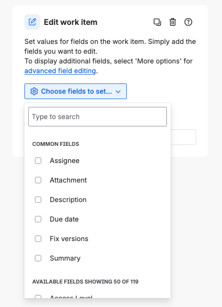

You should be able to populate that field with Automation, much like what @Hermance NDounga shared. I don't see "Project Target in any of my pre-built demo projects, so I assume that's a custom field you've created for your teams.
From what you stated before, I'm going to assume that you cannot find the "Project Target" field when you're building an automation rule. Specifically, you cannot find this when you configure the "Edit Work" action.
What we can do instead is leverage the "Additional Fields" options as part of this action, and attempt to populate the field that way.

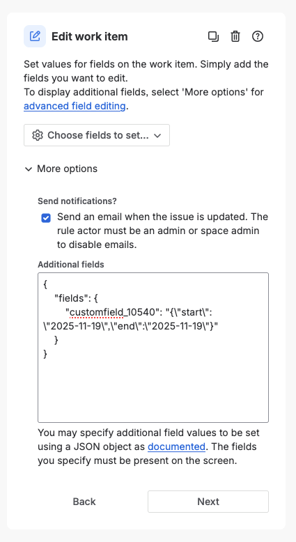

  1. In your automation rule, create an Edit Work Item action.
  2. Under "More Options", expand the "Advanced Fields" menu.
  3. Paste the following JSON (with adjusted customfield IDs) into the dialogue
"fields": {
"<PROJECT TARGET>": "{\"start\":\"{{<PROJECT START> .plusHours(<DEV EFFORT> * 100 / <AVAILABILITY RATE>)}}\",\"end\":\"{{<PROJECT START> .plusHours(<DEV EFFORT> * 100 / <AVAILABILITY RATE>)}}\"}"
--- or with the custom field IDs spoofed:
"fields": {
"customfield_10111": "{\"start\":\"{{issue.customfield_10222.plusHours(issue.customfield_10333 * 100 / issue.customfield_10444)}}\",\"end\":\"{{issue.customfield_10222.plusHours(issue.customfield_10333 * 100 / issue.customfield_10444)}}\"}"
That should do it! Give that a try and let me know how it's working.
Here's a screenshot of my example, without the more complicated maths.

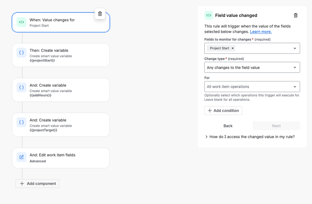

Okay, @Paul Wijnen , after some additional testing, here's my updated recommendation:
We should use multiple "Create Variable" entries to simplify the automation and JSON entry.

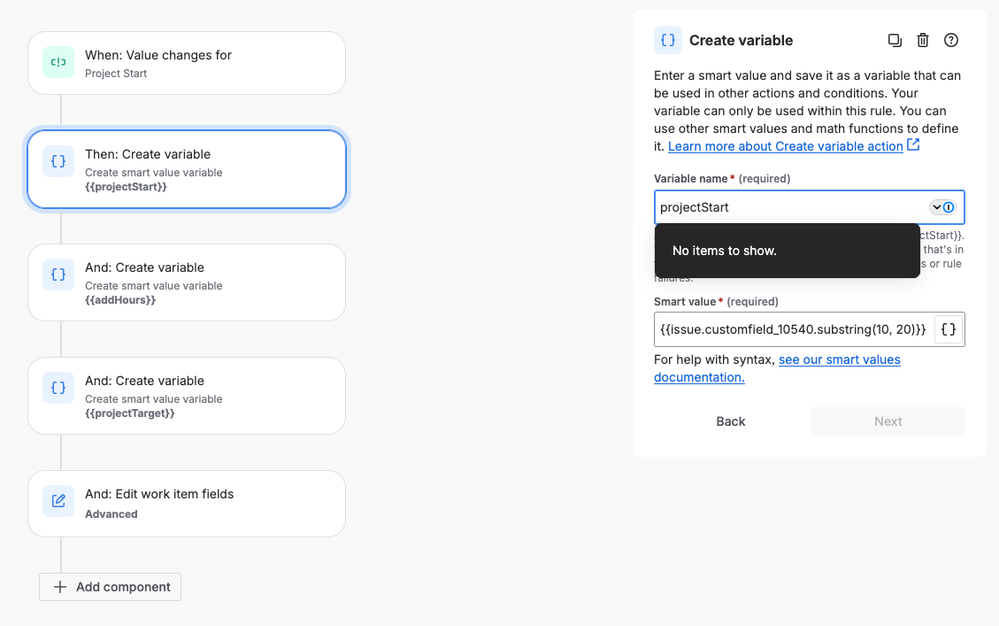

Create a "Create Variable" action to capture the current Project Start date.
We will use the substring command to pull the first date out of this entry. Let's call this variable "projectStart".
{{issue.customfield_10540.substring(10, 20)}}

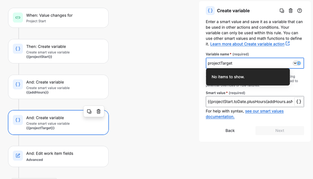

Create a "Create Variable" action to capture the new Project Target date value.
We will use date math to add the number of hours to the start date, and then only keep the date itself (not the leftover hours). Let's call this variable "projectTarget".
{{projectStart.toDate.plusHours(addHours.asNumber)}}

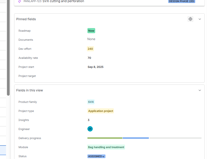

Paul Wijnen
November 20, 2025
Hi Robert, @Robert DaSilva
What im trying to do is calculate the project target date based on the project start date, the development effort in hours and the availability rate (70% available capacity)
