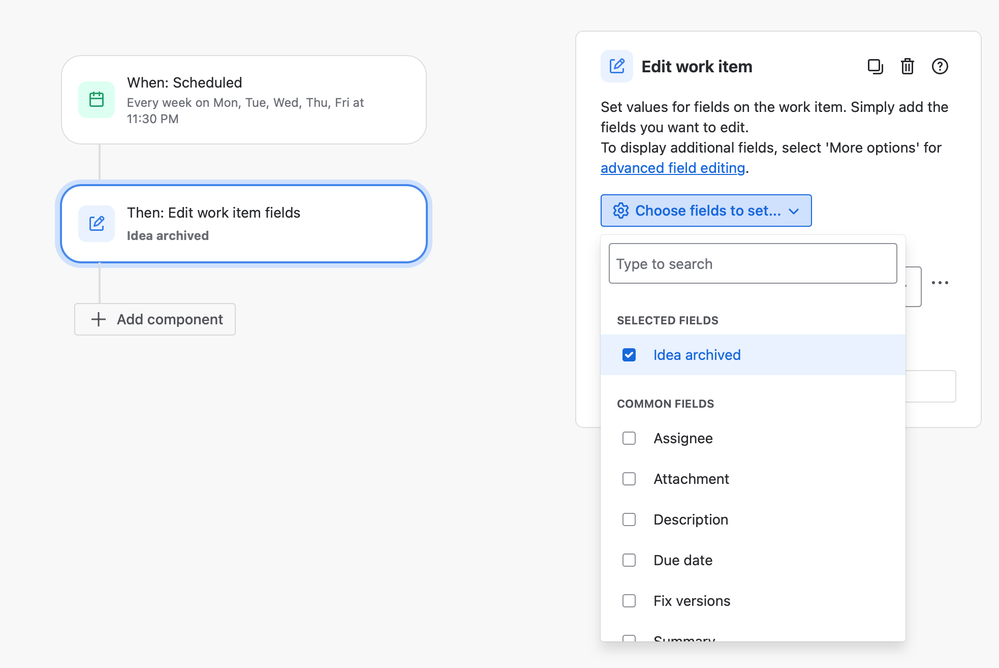

Bildschirmfoto 2025-04-22 um 14.08.18.pngBildschirmfoto 2025-04-22 um 14.08.26.png

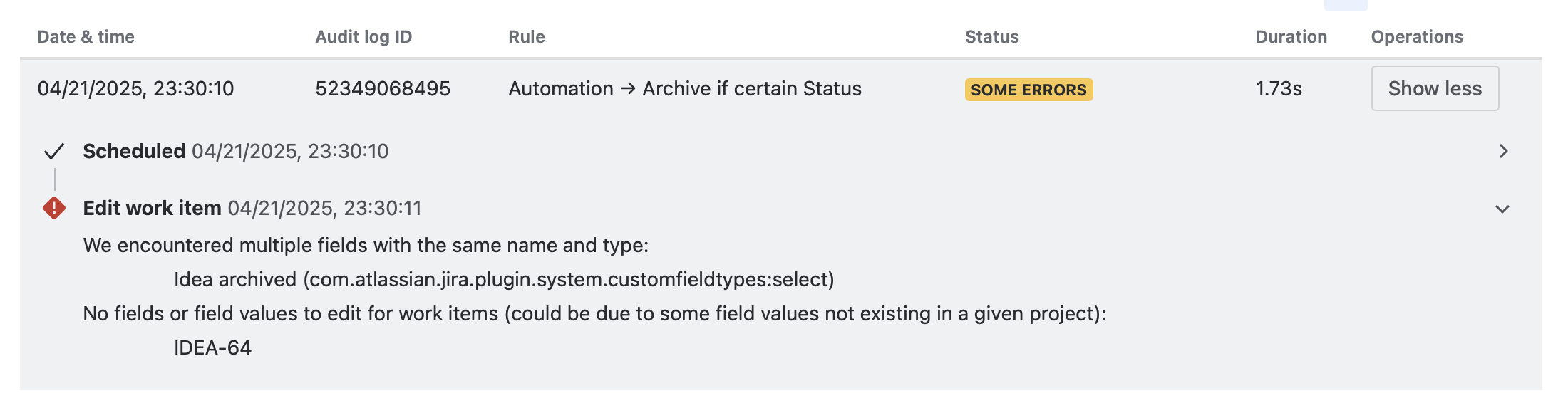

So the Audit log shows:

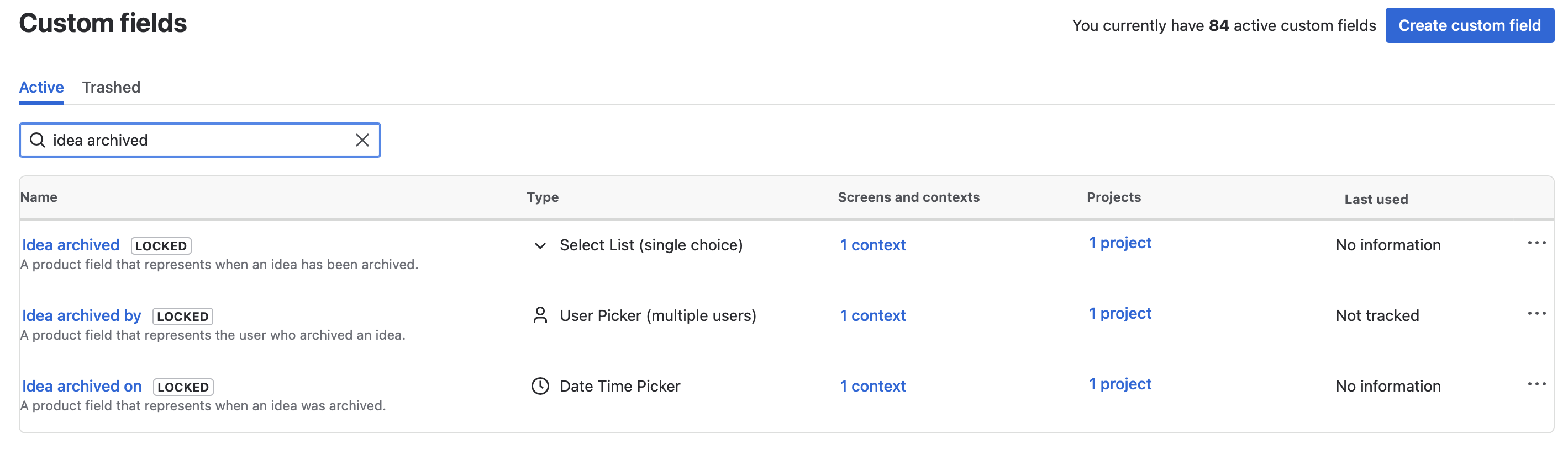

I find the "Idea archived" field in the custom field section, but I have no clue how to find the correct name to add it to my JQL.
It could be a problem with the fields:
Any solutions?

My team faced the same issue lately. After working with Atlassian Support, we discovered that this is due to a backend change they're making to migrate the Idea archived field to a single global field, rather than separate project-specific fields. Right now, however, there's both a global field and project fields, so the error you're receiving indicates that automation is unable to determine which one to use.
According to support:
Our team will soon migrate all project-scoped fields to global fields to allow consistent use of automation rules across all projects without needing to identify specific field IDs. However, we don't have an exact timeline on when it will be rolled out to all our users.
In the meantime, your automation rule will need to be updated to reference the project-level field ID specifically. You can verify the global and project field IDs by following these steps:
  1. Navigate to https://<Your_SITE>.atlassian.net/rest/api/3/issue/createmeta?projectKeys=<ProjectKEY>&expand=projects.issuetypes.fields
    1. Two "Idea Archived" field IDs will be displayed.
  2. Identify the system field ID by navigating to https://<Your_SITE>.atlassian.net/secure/admin/ViewCustomFields.jspa?customFieldStatus=Active&page=1&searchFilter=idea%20archived
    1. Click on "More (three-dot icon)" > "View field information." The URL will show the Field ID.
  3. With the system field ID, you can identify the project field ID, which is the one you should use for automation in your JPD project.

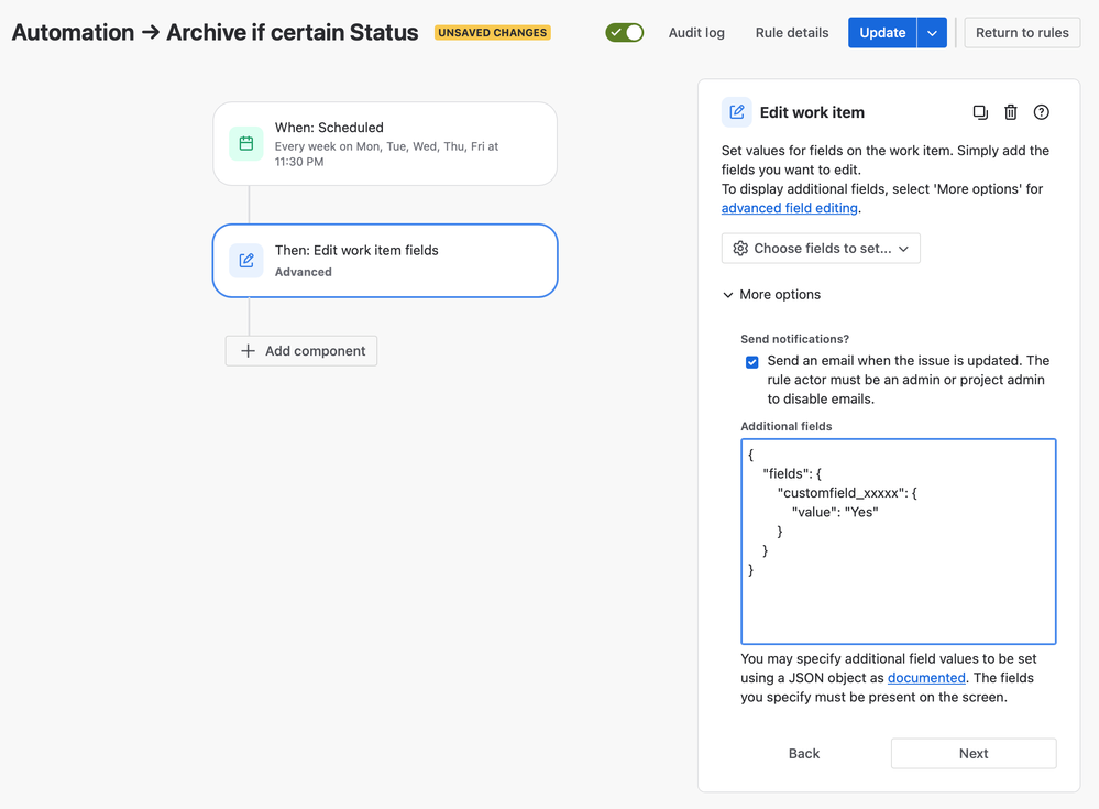

I was successful with 1 and 2 - but for 3, I don't know where to include this information in my automation.
I found the two Custom Fields (customfield_xxxx1 and customfield_xxxx2)
The automation was working, but the issues are still not in the archive.
I tried with both custom fields using it in the "Then" Advanced Section in the Automation as
"fields": {
"customfield_xxxx1": {
"value": "Yes"

In the trigger my JSON is:
project = IDEA AND status IN ("Migrated to DEV", "Offer Denied", "Won't Do") AND "Idea archived" is EMPTY
And my Then section is
The JSON finds the right issues and the automation has no error. But the issues are not in the archive.
Any idea what's wrong?

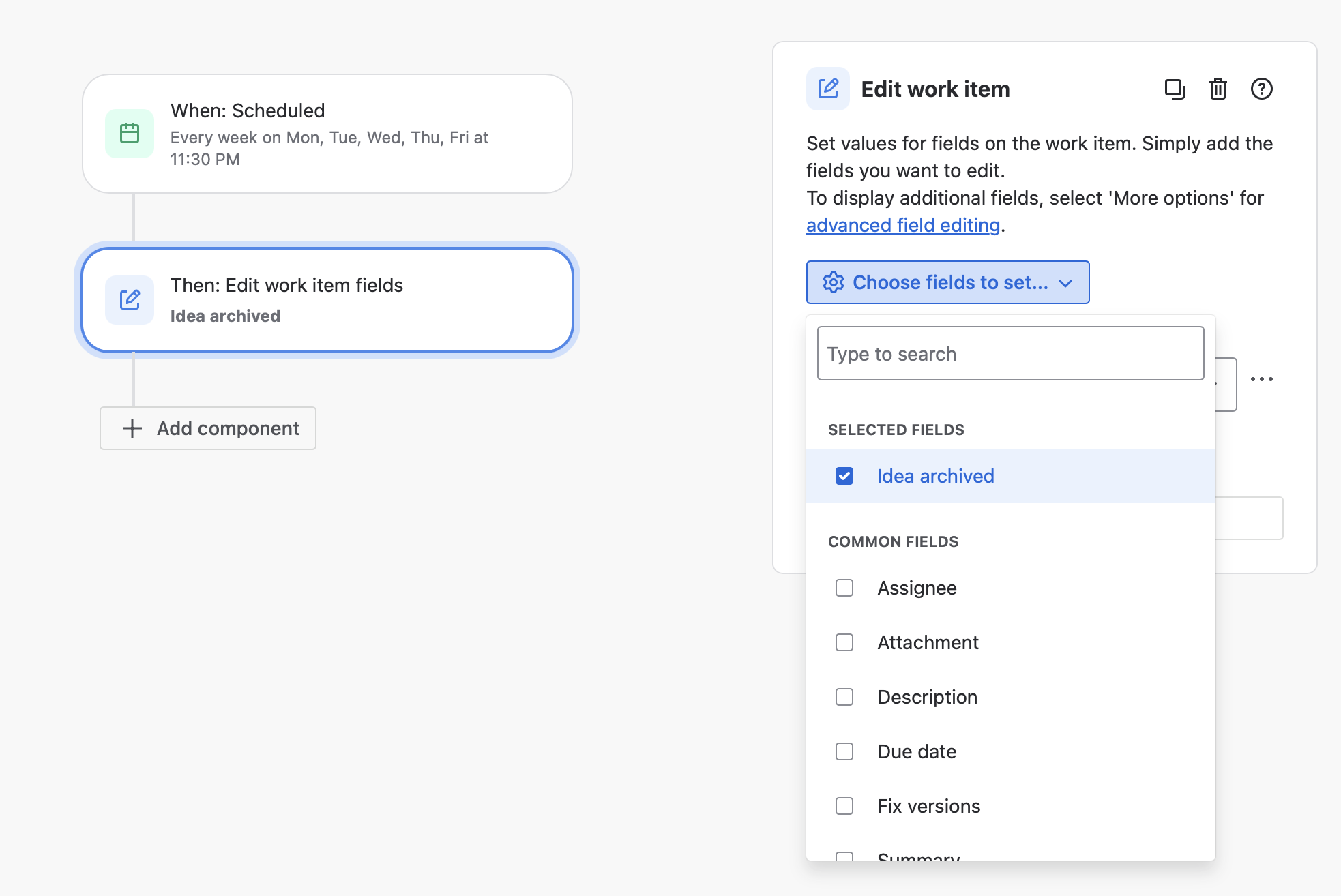

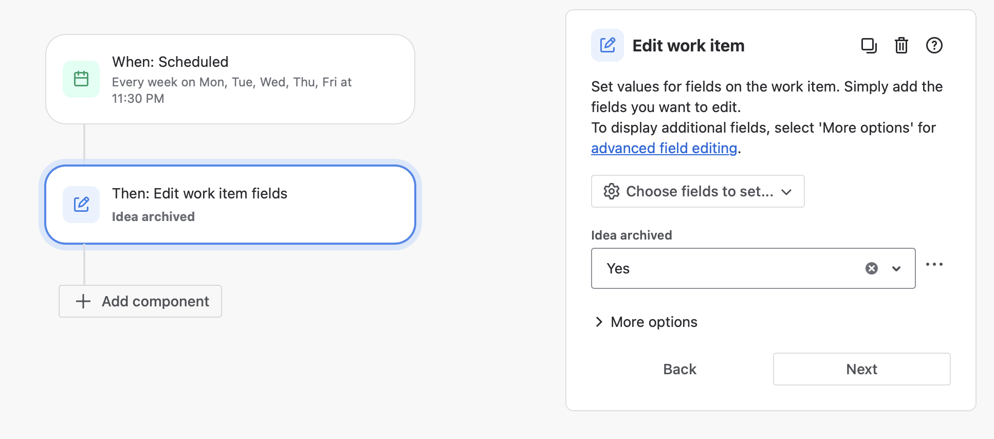

So what could be the solution looking at my THEN section

Hi @Dominik apologies for the inconvenience. From your previous messages, it seems that your setup is correct, but you're using the global field for archiving.
We published an article on this topic yesterday, which you can follow to ensure everything is set up correctly: https://community.atlassian.com/forums/Jira-Product-Discovery-articles/Notice-Automation-Jira-Filters-and-workflows-on-archiving-fields/ba-p/3008866
Paying particular attention to step 13 might be helpful for you.
In summary:
Even though the ideas have a "Yes" value in the global Idea archived field, they don't appear as "archived" right now. This is because the archival state is currently managed by the project-level fields (for you, customfield_10086). As we move forward with our migration, your project will begin using the global fields. At that time, the archival state will be controlled by the global field, and those ideas will move to the Archived view correctly.
If it doesn't bother you that these ideas appear in your regular views for the next few weeks, there's no need to make any changes. Otherwise you can follow the article I linked to set up a duplicate automation rule with project-level field.

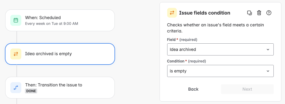

Does the JQL query work in the issue search view? Switching from basic search to JQL gives me this query:
status IN ("To Do", Done) AND "idea archived[dropdown]" is empty
If the JQL query is buggy, using the "Idea archived is empty" part as a separate condition in your automation should fix the issue:
Hope this helps!
- Manon
