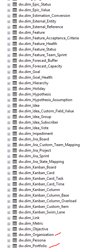

Hi Sam, Thank you again. It is really helpful..  Are we sure we have to use the current_dw schema tables as I also see the dw.dim_organization
do you know the difference between the dw.dim_organization and current_dw.[Organization]   - This will clear my doubt and get starting...
just wondering why we have 2 for the same table - export lets not worry about this for now

Thank you Sam, I looked at the Video - I see so many tables when i go to SQL server Mgt Studio and expand the tables (not the views) I see many tables - just as example
Are these not coming from jira align into EI ?
Do you think our org might have request the jira align to build those tables within EI?

@Raj It looks like you may have an on-prem version of Jira Align and Enterprise Insights. If you have on-prem Enterprise Insights, your administrator can create the login accounts with whatever permissions you want. For the Enterprise Insights cloud versions, users cannot see the dw.dim_ tables at all. Those dim tables are used for the Enterprise Insights ETL process and strongly advise not using them. You should only use the views in the current_dw or export_dw schema.

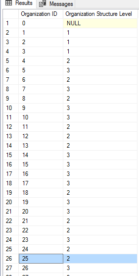

in my Org table i have an Org ID for each and there is another field that says org structure level with values like 0 1 2 3 - since Iam only looking at one particular org ID
When do we use the  org able multiple times ? - my portfolio table has org id as FK so i am confused on why we need the org table multiple times

Depending on how many Organization levels are configured in your Jira Align instance you may need to join the Organization table several times.
This is little bit confusing .. I have Organization ID in the main org table and the organization ID is available in some tables as FK Organization ID..
What is the reason to use this table so many times or several times..
For example: for analysis purpose i am only looking at the organization ID = 25 so i filtered it on org table to get the 25 record only...
could you please explain on why i have to use the org table several times - 1 join for 1 level? thanks a lot
