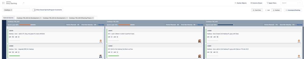

For you last question about loaded versus actual.  Check out the Story Backlog -> Kanban -> Sprint View as a possible view of what you are looking for.
Hope this helps.  Let us know if you have more questions.
