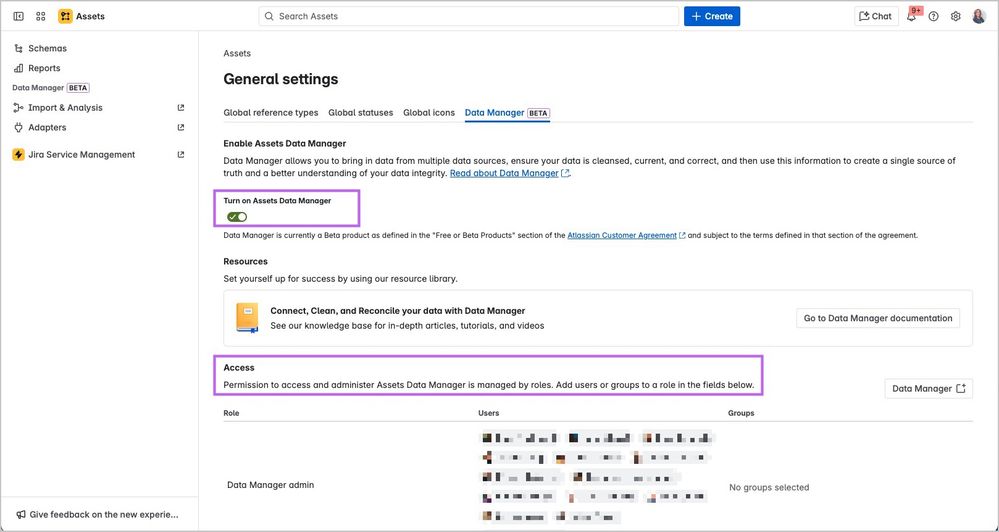

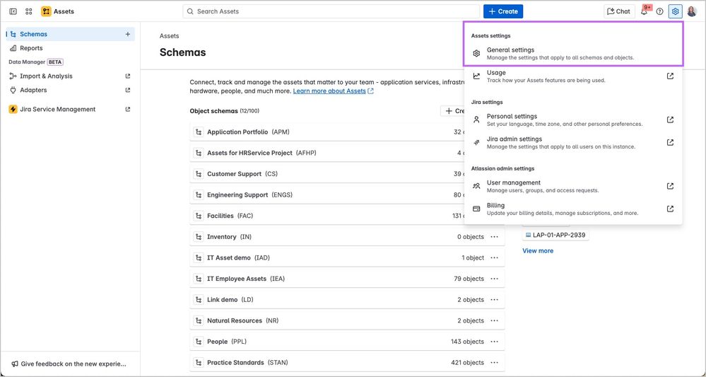

Go to Assets settings:
To enable Data Manager, first, navigate to the Data Manager tab. Then, toggle the “Turn on Assets Data Manager” option to activate it and configure the necessary permissions. After completing these two steps, you are ready to begin setting up Data Manager.
Please be aware that your Data Manager instance will initially appear empty. This is because you need to configure the data source integrations, as well as address the mapping, cleansing, and reconciliation processes. Additionally, you will need to set up analysis and dashboards.

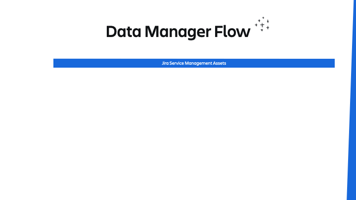

For an overview, watch this video that outlines the steps to configure Data Manager: Data Manager flow and how to configure [15 min].

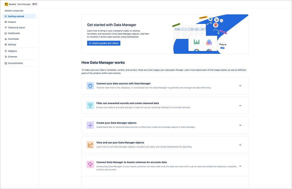

An alternative way to learn how to set up Data Manager is by following the in-product setup guide.
To access the Data Manager in-product guide, simply click on the “Import and Analysis” menu option. From there, you can easily navigate through the various stages to set up Data Manager.

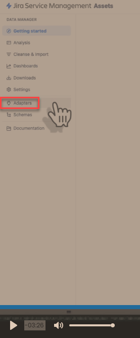

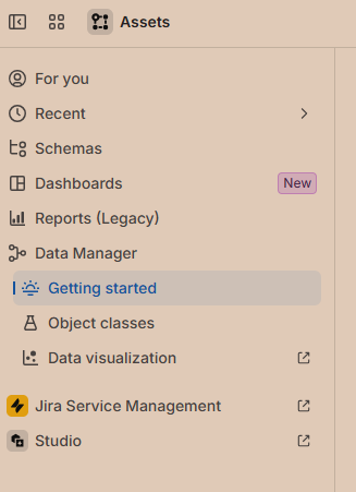

Phelan_ Miranda
September 4, 2026
I am just learning about assets and data manager. My sandbox has the new experience and my production has the old experience. I built everything in sandbox and now I'm trying to deploy it to production. It took a long time to learn assets in the new experience and now I have to learn it all again in the old experience. I can't find any guides or instructions on how to do things in the old experience.
Specifically, I'm trying to create a transform. Help!
Silvia Davis
September 4, 2026
Phelan_ Miranda
September 8, 2026
In your video "How to transform the data" it shows:
In my view I see:
There is no "Adapters" option.
