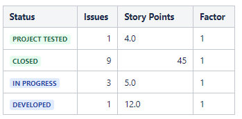

My 'Factor' always comes out as 1.

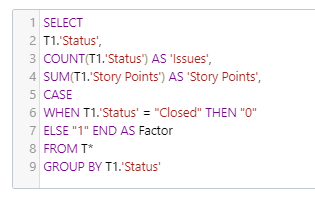

Hi @Stiltsoft support
Thanks for the quick reply, but it's not worked....
I updated my query...
But the result is the same...

The 'Factor' is not in the quotes - it is a column name as well.
Besides you may leave the THEN 0 and ELSE 1 without the quotes as they are numbers and not text.

It doesn't like Factor in double quotes (displays a syntax error) and in single quotes I get the same result - i.e. always 1 (with or without quotes around the 0 and 1).

Seems the initial structure is not correct:
COUNT, SUM and GROUP BY 'Status' count smth and group it by statuses (so you get as many rows in the result table as you have different statuses).
But the CASE WHEN part simply takes your table row by row and places specific numbers considering the status.
So, everything is mixed-up.
Maybe you need smth like this:
SELECT
'Status',
COUNT('Status') AS 'Issues',
SUM('Story points') AS 'Story points',
SUM('Factor') AS 'Factor'
FROM(
SELECT *,
CASE WHEN 'Status' IS "Closed"
THEN 0
ELSE 1
END
AS 'Factor'
FROM T1)
GROUP BY 'Status'
Here we have the internal SELECT where we show all the columns and introduce the new 'Factor' column based on the CASE WHEN condition. Here we can refer to our table as T1.
And the external SELECT takes this new table with the additional 'Factor' column and do the aggregation. Here you can't write T1.'Column name', only the 'Column name' will do - now we work not with the original T1 table.
Here SUM('Factor') AS 'Factor' serves just for an example that firstly you need to set your values based on the condition row by row and only then group these values in the external SELECT.
You may clarify what you need to to do with the 'Factor' column and I'll try to help.
