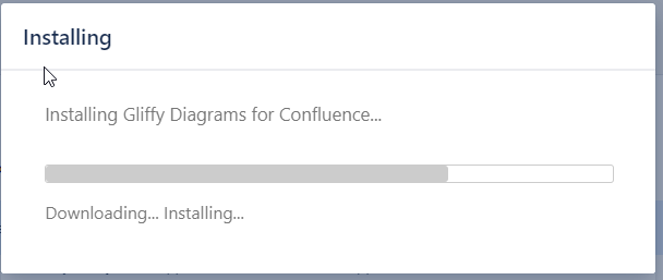

When trying to installing Gliffy gliffy-confluence-plugin-9.1.3.obr on our server 7.4.11 it  hangs at the spinning wheel window.  I've tried rebooting and restarting the services.  Same results.  I've tried other versions also. I have already contacted the vendor of gliffy and was unable to help.

I just upgraded Confluence to 7.13.4. I tried updating Gliffy Diagrams through the Manage Apps, and the installing just hangs...it's been like this for a day now. I can't do anything else in the Manage Apps because this is in the way.2022-02-13 22_18_12-Manage apps.png
Anyone found a solution?
