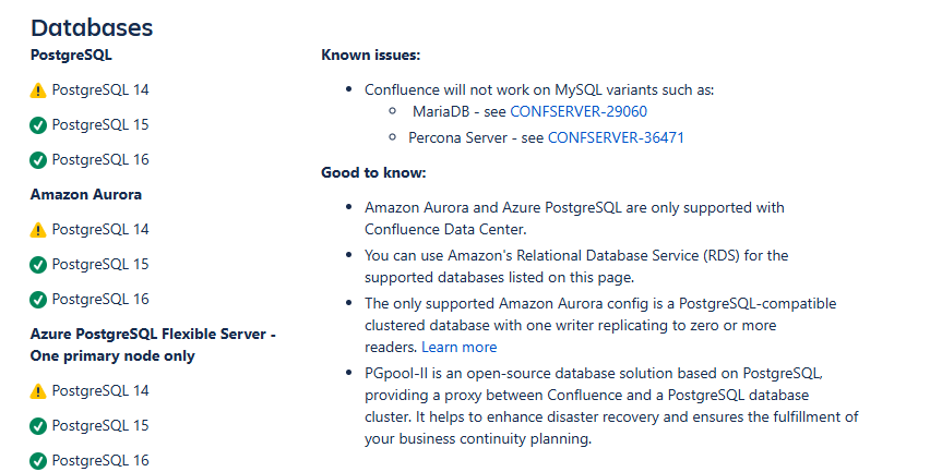

postgres 17 not supported?

Base on the documentation no.

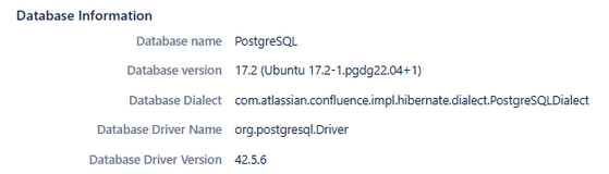

Very interesting! 8.5.18 is working on PostgreSQL 17)

If it's not in the supported platform list it do not means it will not work. Atlassian will most likely do not investigate if you raise any ticket that could be due to database issue because they do not test nor support this version.
