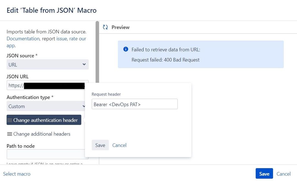

I am trying to use the 'Table from JSON' macro to retrieve data from Azure DevOps, via the API endpoints exposed for query data from that platform.
I want to use a personal access token (PAT) from Azure DevOps, but I'm really not clear how to configure the macro to use this, and certainly not getting anything back into the macro, so far!
I enter the JSON URL (obviously with placeholders to not expose company specifics!), such as:
https://<devops_org>/<devops_instance>/<devops_project>/_apis/wit/wiql/1cb4290a-7faa-4bb8-8a15-8211af5e2b14
The actual endpoint returns JSON data, no problem.
I'm not sure how to enter data into the dialogs to use the PAT? I select 'Authentication type' as 'Custom' and then click on 'Change authentication header'.
In the 'Request header' dialog and field I have tried entering each of (again substituting placeholders which are for illustration here):
Bearer <Azure PAT>
Authorization: Basic <Azure PAT>
Authorization: Basic <Azure PAT Base64 encoded>
I get a 'Failed to retrieve data from URL: Request failed: 400 Bad Request

The instructions are about using PAT's from Jira, Bitbucket or GitLab, but I assume the same is also relevant for Azure DevOps. Point 5 confuses me, as I don't see a 'Change request header' but instead select 'Change authentication header' and enter Bearer <Azure PAT>, as I described earlier.

I selected 'Change authentication header' and in the 'Request header' textbox entered:
Bearer {Azure PAT}
I still get this:
What am I doing wrong?
