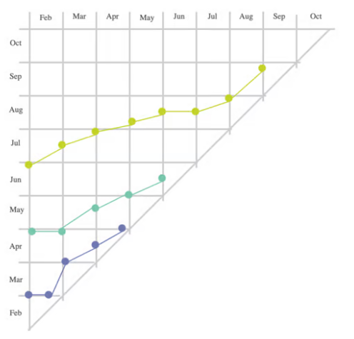

as a project manager I would like to generate a chat representing the milestone prediction to a certain date. As a figure is more worth than a word....I am looking for something similar like this.
How must my table look like and how to set up the tool "chart from table" to retrieve a similar figure?

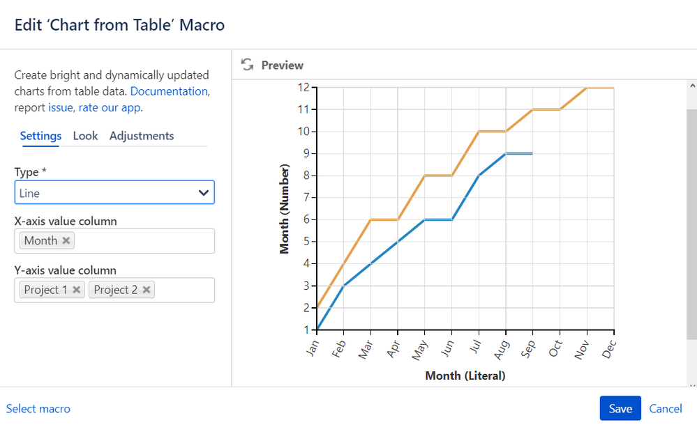

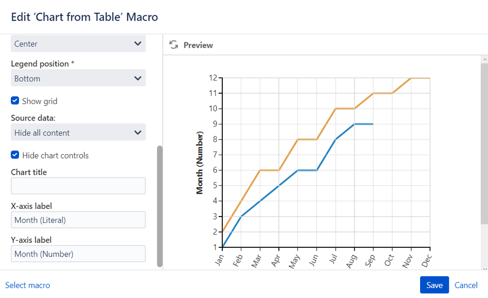

Hi @Stephan Schmitz,

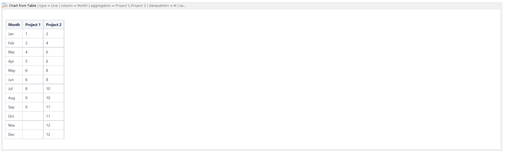

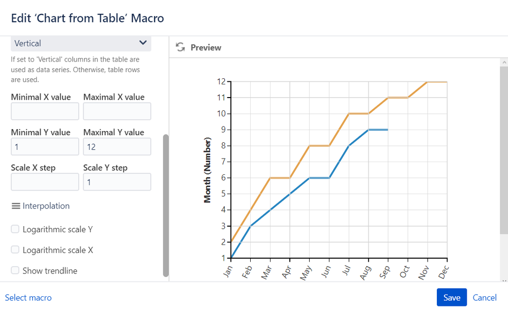

I can suggest the following workaround using the Line chart:
Неre you use full months’ names as X-axis values and set numeric values from 1 to 12 that correspond to the months’ numbers for Y-values.
Also you may check our Gantt chart that is rather advanced and may be more suitable for the project tracking.

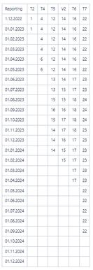

Dear @Katerina Rudkovskaya [Stiltsoft] ,

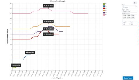

thank you very much for the time spent on my problem, I really do appreciate it. Your tip helped me to get further. It dawned to me that I must somehow modify my requirements and came up with the following.
I changed the months into a date (x-axis) and the project timing I started to count in months (y-axis). Now I can see how different milestones are progressing over time.
However I am not able to modify the x-axis into month year scaling, it stays with date month year...but I can live with that.

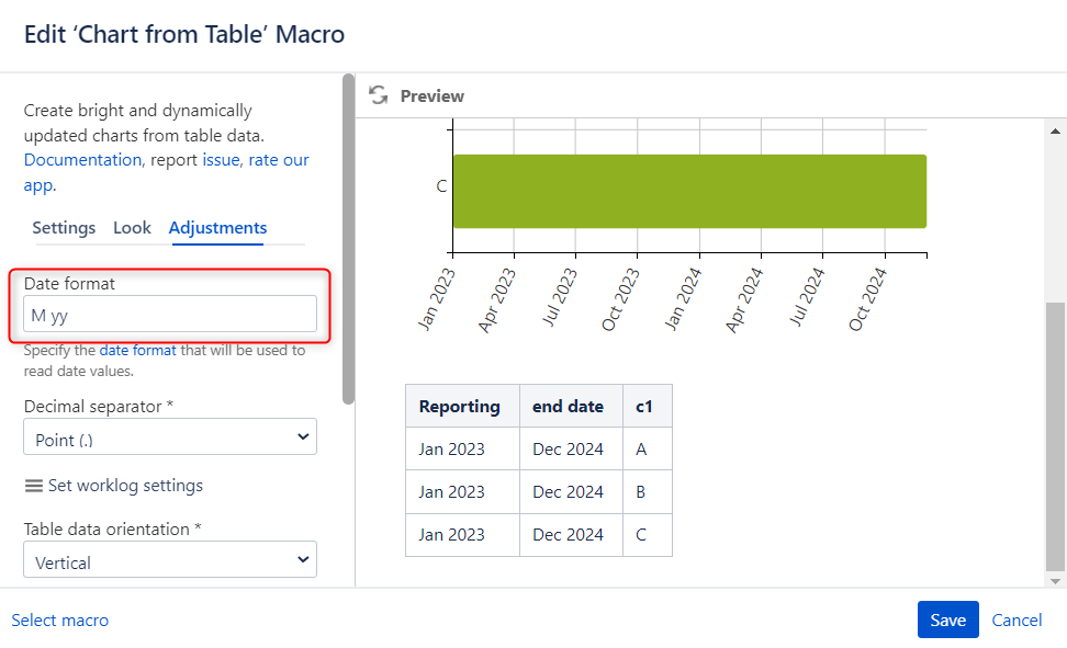

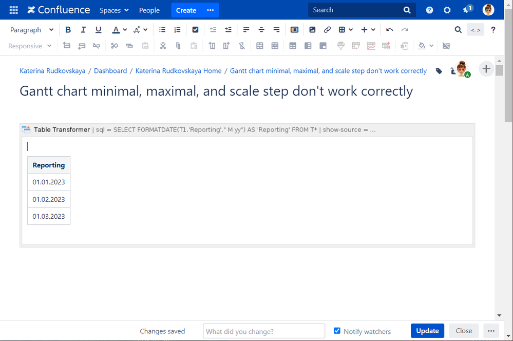

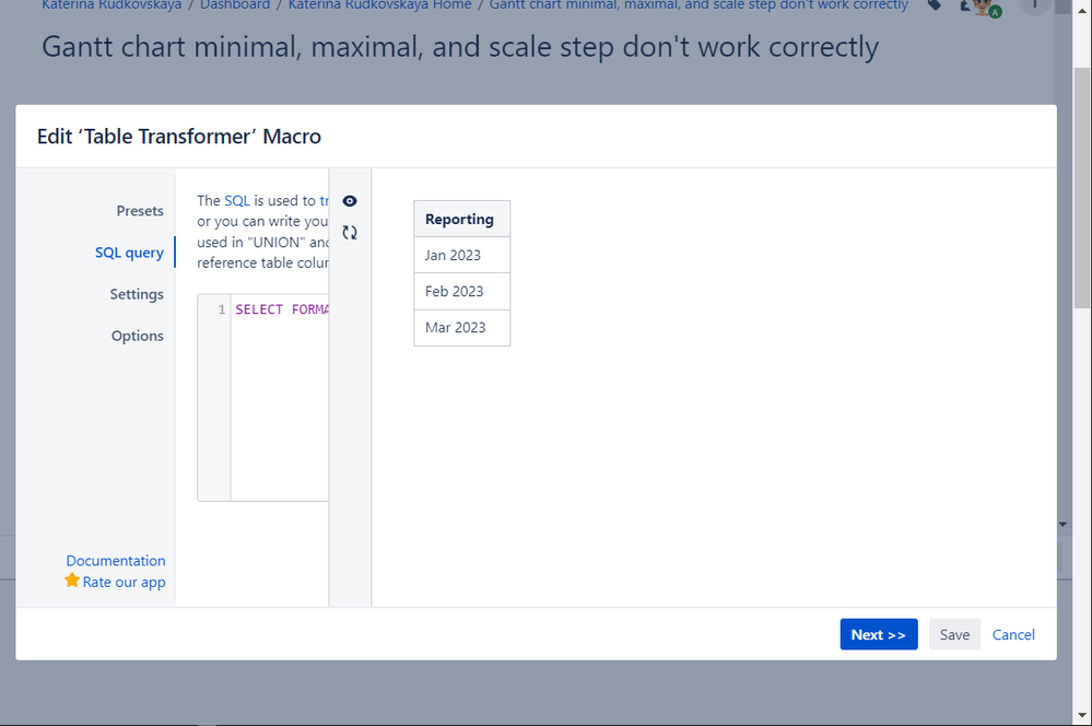

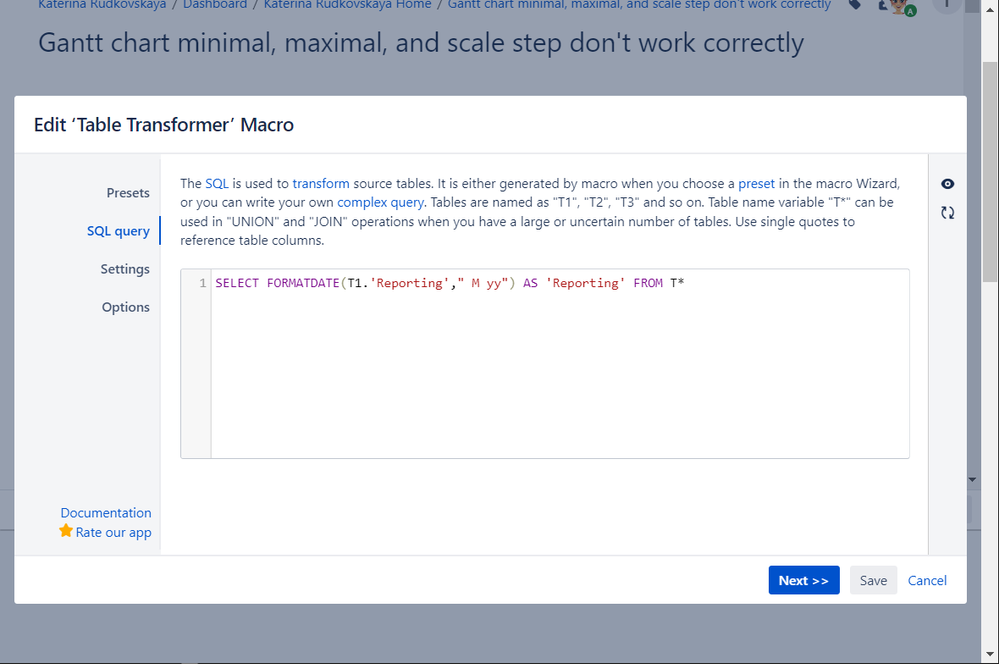

You can change the date format in the Reporting column of your source table to have it in the x-axis of the chart then. It's possible to do with the help of Table Transformer.
Please see the example below:
2023-02-11_02h00_55.png2023-02-11_01h57_32.png2023-02-11_01h57_29.png2023-02-11_02h05_09.png
