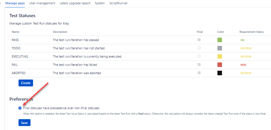

Hi @rajeswari saravanan ~ I'm not sure if this is it but do you have this option checked (https://<yoursite>/secure/admin/views/XrayTestStatusConfiguration.jspa)

Is there any other way like using Jql to find the specific stases
As in manage apps the final status checkbox is unchecked and its global change we cant change it
