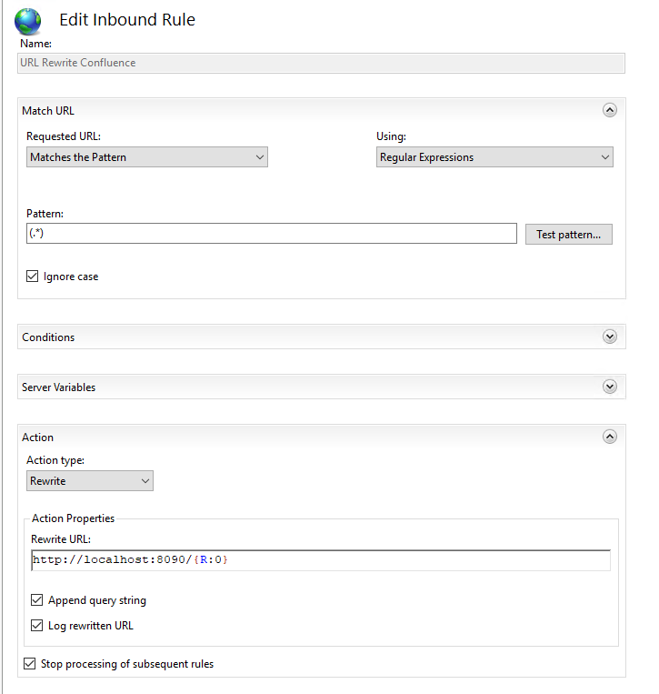

Zhi Lu
February 19, 2021
Hi Micko,
I am running into exactly the same problem...
Have tried to update the URL rewrite to {R:0} but still it doesn't work.
"Adding a trailing back slash" - could you please exlain more on this? thanks.

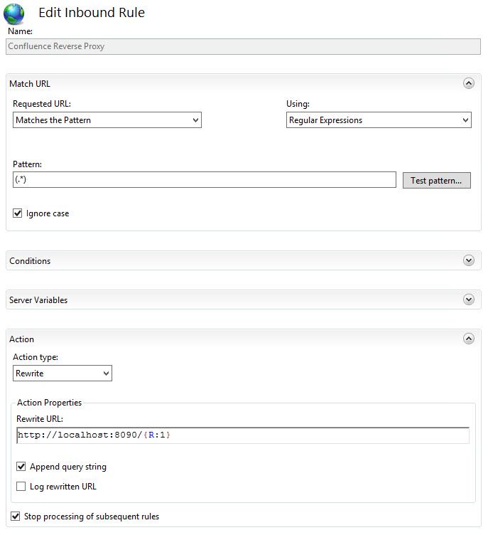

My current rule uses {R:1}. My description of the solution is misleading.
Micko
February 22, 2021
I'm not sure why my screenshot was dropped. This is my current rule but it uses a subdomain "https://confluence.domain.com" so I do need everything after the domain.

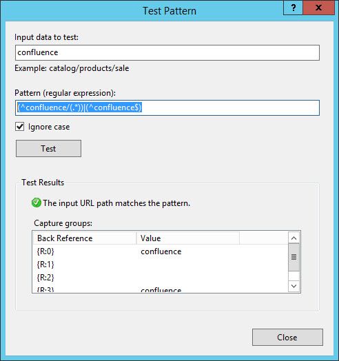

Just to clarify, I wasn't detailing a solution at the time, just that my rule was incorrect and to check your own rules. I've also switched to subdomains since then so the rule was dealing with multiple sites under the one domain. R:0 takes the entire input but R:1 only matches the pattern so in both our rules, R:0 and R:1 are the same as there is no component of the pattern outside the braces.

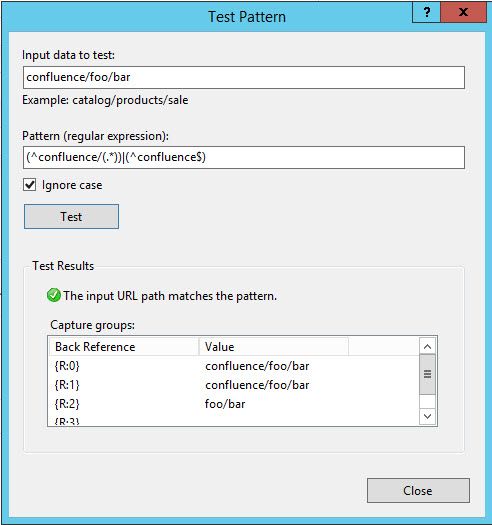

The trailing backslash was in reference to this rule (^confluence/(.*))|(^confluence$). In this case, if the pattern was confluence on it's own, only R:0 contained confluence, R:1 was blank. If I added a backslash, confluence/ then both R:0 and R:1 contain confluence/. This meant the rule using R:1 was working for longer patterns but not for the base domain.
"https://domain.com/confluence" failed.
"https://domain.com/confluence/" worked.
"https://domain.com/confluence/foo/bar" also worked.
