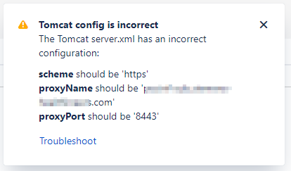

After awhile I get the hint Tomcat config is incorrect:

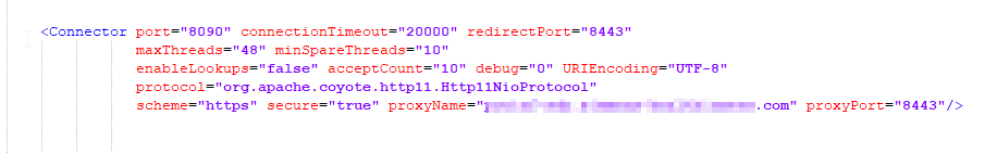

But in the server.xml the parameter are correct.
