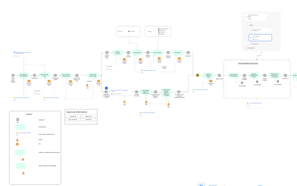

I used also Draw.io but was eager to get to whiteboards because of the collaboration feature. I use WB for process mapping. It gives possibility to embed on WB as process to other WB process and if you have risk you make risk register in Jira and add that risk to correct place in the provcess. The same way for nonconformities happening in process can be higlightedKuvatõmmis 2025-08-20 105536.png

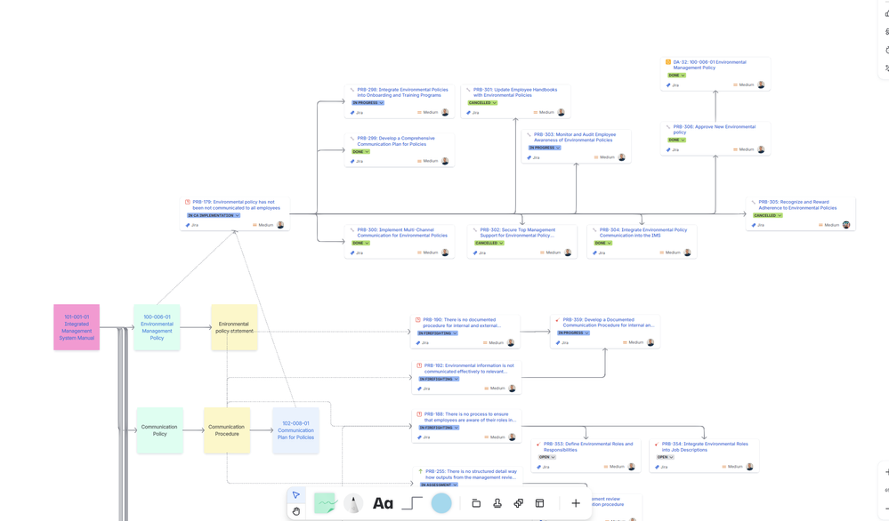

So you would not have @Markus Witschi problem of 3 whiteboards you need to get Premium and then you have I think 3000 whiteboards or so.
Why to move to confluence whiteboards
  1. You can make tasks with couple of clicks from all the notes to Jira
  2. You can connect Jira tasks to whiteboards with being up to date
  3. Try to do that in Miro with all the connections to JiraKuvatõmmis 2025-08-19 120704.png
