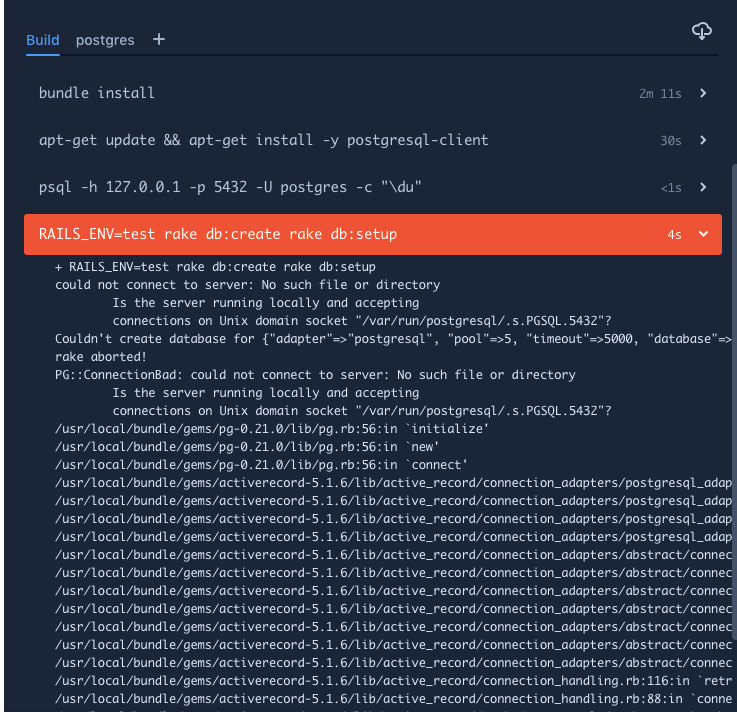

but always get an error when rake db:setup. It said that cannot connect postgres:
<span>+ bundle exec rake db:setup db:migrate RAILS_ENV=test</span><span>could not connect to server: No such file or directory</span><span> Is the server running locally and accepting</span><span> connections on Unix domain socket "/var/run/postgresql/.s.PGSQL.5432"?</span>

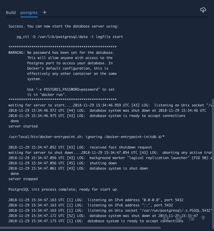

but I can see that the postgres is running when building this pipeline. Does anybody meet the same problem?
