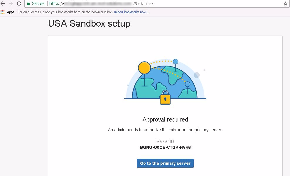

Hello Team:

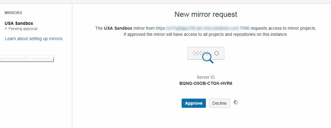

I have installed a mirror server but while approving it from master I'm seeing below error,
Failed to approve USA Sandbox.
Failed to install mirror USA Sandbox from /rest/mirroring/latest/upstreamServers/b4d732ca-cfb2-3814-a395-bf8489cb2988/addon/descriptor (Reason 'javax.net.ssl.SSLHandshakeException: General SSLEngine problem')
I'm running both instance on https but SSL certificate vendor is different
