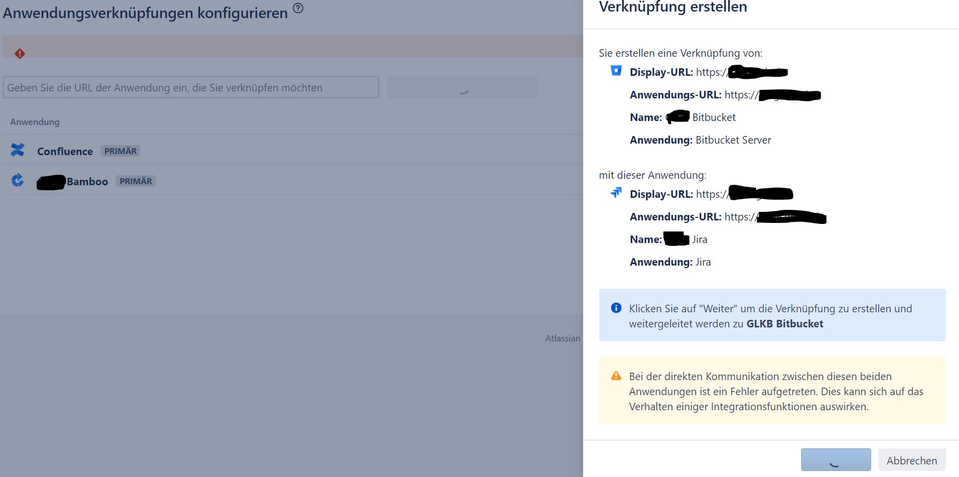

  • I go to Bitbucket Admin Menu and try to link my Jira
  • Redirect to Jira and there i get an error

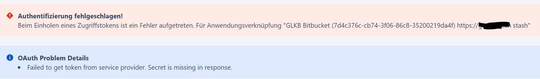

After click "Fortfahren" in Jira, it loads endless. I cancel it, and see the following in Jira:
In Bitbucket Status is green:

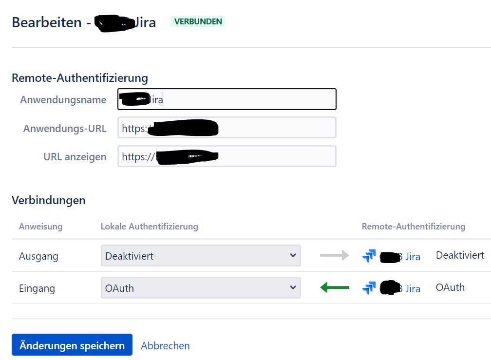

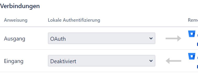

If I know want to set (on Jira) the connection entry to OAuth, it shows an error, that bitbucket is not reachable.
On Jira I also can click authenicate to see Status (Authentifizieren Sie sich, um den Status zu sehen) and then I get the following error.
I still think the error is on Bitbucket, because all other applications worked (Jira, Confluence and Bamboo).
