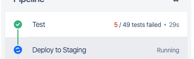

I have recently noticed that if I run tests in my pipeline and some tests are failing, that my pipeline will report the failed tests correctly, but won't stop. It happily continues with defective code, in my case deploying it to Staging.
I honestly would expect a CI/CD Pipeline to fail, rather than to ignore it.
What do I do: I run jasmine tests that write to an xml file and i make sure that this file is picked up by pipelines as described here: https://confluence.atlassian.com/bitbucket/test-reporting-in-pipelines-939708543.html
As you can see in the screenshot, it detects my reporting and correctly marks some tests as tailed. But the step itself does not fail.
I cannot find an option to change this behaviour.
Hi @Bastian Brodbeck, which testing framework do you use? Test reporting is somewhat independent from pipelines being successful or failed. In general, the pipeline will only fail if the exit code of the bash command is non-zero. However, test reporting only shows you the amount of tests that passed or failed and doesn't affect the build status.
