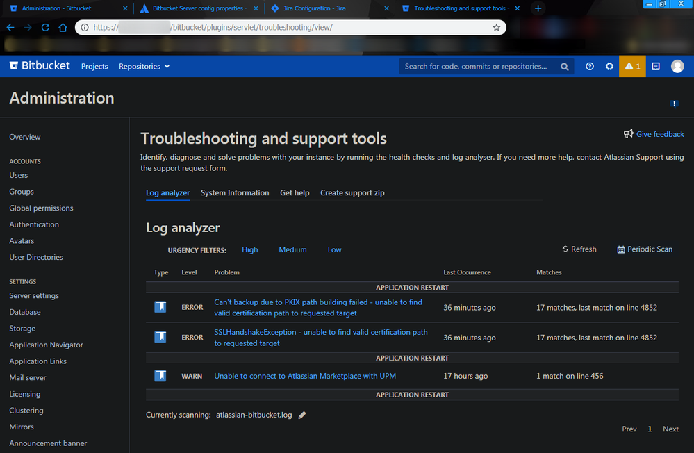

I am experiencing what seems like the exact same issue.  Here's what I'm seeing.

If you go to your Troubleshooting and Support tools page (https://bitbucket.mycompany.com/plugins/servlet/troubleshooting/view/) then Elasticsearch, what information is displayed?
