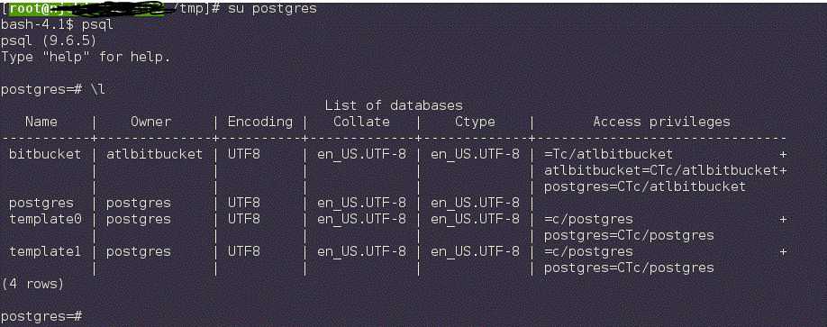

I am working on a DR backup + restore script to get our BB instance up and running.
we are using Postgres
I am backing up my BB db using
pg_dump bitbucket > bitbucket.dump
restoring it
pg_restore -v -c -d bitbucket bitbucket.dump
no errors during restore
Starting BB, it tries to create a table databasechangeloglock  (its already there)
I gave the 'atlbitbucket' user all privileges on teh DB, no idea how to get it to start correctly
Caused by: liquibase.exception.LockException: liquibase.exception.DatabaseException: ERROR: no schema has been selected to create in
Position: 14 [Failed SQL: CREATE TABLE databasechangeloglock (ID INT NOT NULL, LOCKED BOOLEAN NOT NULL, LOCKGRANTED TIMESTAMP WITHOUT TIME ZONE, LOCKEDBY VARCHAR(255), CONSTRAINT PK_DATABASECHANGELOGLOCK PRIMARY KEY (ID))]
