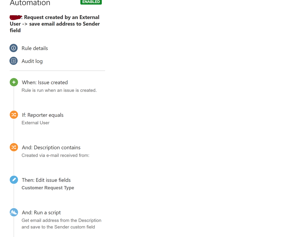

Hi Ram,
I'm not invoking the method as automationScriptName.addMessage(). Please see the attached screenshot for automation configuration, automation-script code and the unit test code.

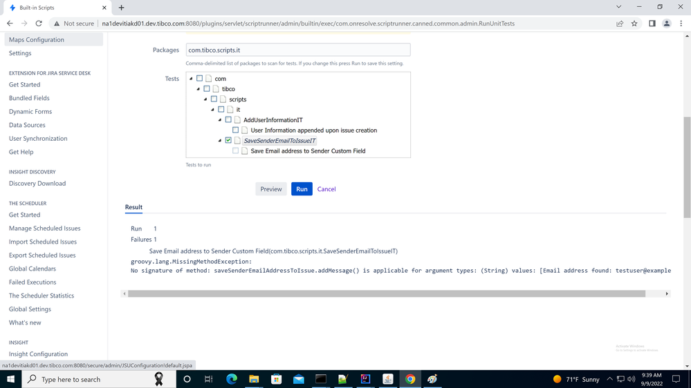

Error displayed in Test runner Built-in script when saveSenderEmailToIssueIT is run:
Run 1
Failures 1
Error Save Email address to Sender Custom Field(com.test.scripts.it.SaveSenderEmailToIssueIT)
groovy.lang.MissingMethodException:
No signature of method: saveSenderEmailAddressToIssue.addMessage() is applicable for argument types: (String) values: [Email address found: testuser@example.com]

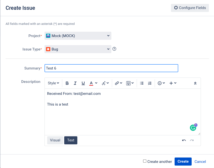

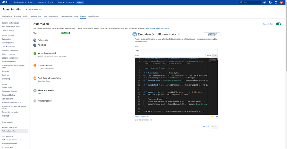

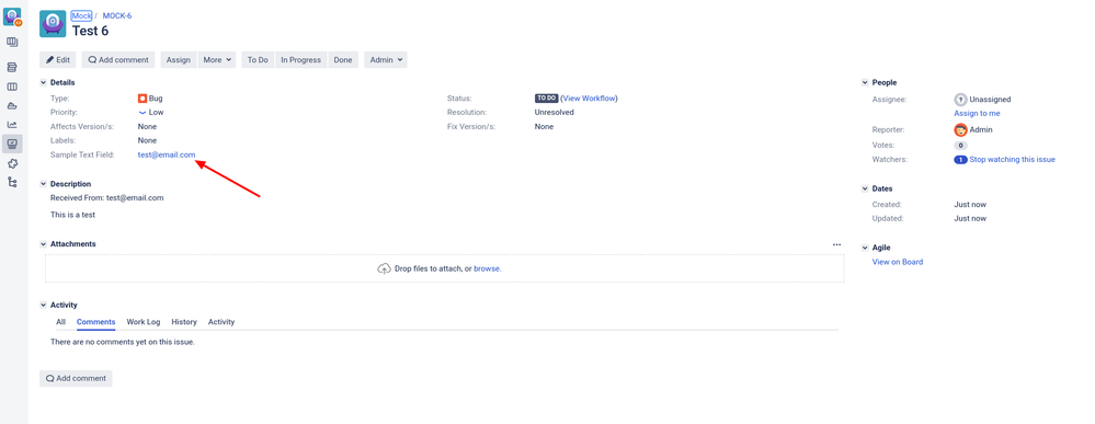

I have tried to run a basic test using Jira's Automation, and I don't seem to be encountering any problems.
Below is the code that I have tested with:-
import com.atlassian.jira.component.ComponentAccessor
import com.atlassian.jira.event.type.EventDispatchOption
import java.util.regex.Pattern
def description = issue.description
def customFieldManager = ComponentAccessor.customFieldManager
def issueManager = ComponentAccessor.issueManager
def loggedInUser = ComponentAccessor.jiraAuthenticationContext.loggedInUser
def sampleText = customFieldManager.getCustomFieldObjectsByName('Sample Text Field').first()
def pattern = Pattern.compile("[A-Za-z0-9._%+-]+@[A-Za-z0-9.-]+\\.[A-Za-z]{2,4}")
def matcher = pattern.matcher(description)
if (matcher.find()) {
issue.setCustomFieldValue(sampleText, matcher.group())
issueManager.updateIssue(loggedInUser, issue, EventDispatchOption.DO_NOT_DISPATCH, false)
Please note that the sample code provided is not 100% exact to your environment. Hence, you will need to make the required modifications.
Below is a screenshot of my automation configuration:-
In my environment, I am not adding any *Then* options.
Below are a few screenshots for your reference:-
I hope this helps to answer your question. :)

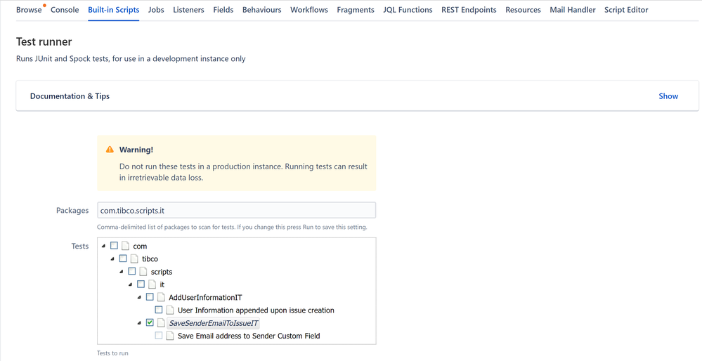

2) You are testing your code through project automation. MissingMethodException on addMessage(string) won't show up when testing through project automation. I'm testing the code through Scriptrunner Built-In Scripts "Test Runner" option. The MissingMethodException on addMessage(string) shows only when testing the code through "Test Runner" option. I have written a unit test code "saveSenderEmailToIssueIT.groovy"(code attached in my previous response). Below are the screen shots of running the unit test through Test Runner.
We have a unit test plug-in created(followed steps in this link:https://scriptrunner.adaptavist.com/latest/jira/testing.html) to include the unit tests for project automation. This plug-in will allow/support our testing effort to be automated.
