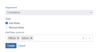

I'm running the latest JSD with Scriptrunner 6.7.0, and I have a simple portal like this:
I'm trying to retrieve the value from a Database Picker field called "Add Roles" in a post function set to trigger when the issue is resolved.
I have the following code, in the post function, to print the value of the field:
def customFieldManager = ComponentAccessor.getCustomFieldManager()
log.debug("Roles: ${issue.getCustomFieldValue(customFieldManager.getCustomFieldObjectsByName("Add Roles")[0])}")
 But when the post function runs, it always prints
Roles: null
despite the field is not empty.

Why does the same piece of code not work in post function, but in Script Console? I can confirm that the field is not hidden or read-only, and printing other fields in the post function using the same syntax always works.

Found the answer here right after posting this...
It appears that I need to set the post function to be processed AFTER the issue is created and re-indexed, etc.
