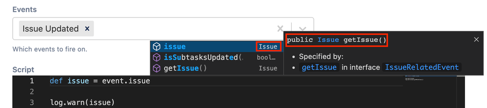

For all the latest versions though, when I create a Listener with the 'Issue Updated' event, I can retrieve an Issue Object by doing:
def issue = event.issue
I can also see the Object type within the Script Editor:
This log message will return the Key (e.g. EG-1), however the object is still an Issue as per the image and Jira API linked above.
log.warn(issue) When using the issue.getCustomFieldValue() you need to use a CustomField Object, as per the API.
