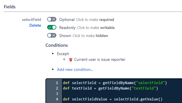

Mathis Hellensberg
July 1, 2020
I see. Then you should be able to add the field to your behaviour, make it Readonly and add a new condition for a certain role or user like so :)

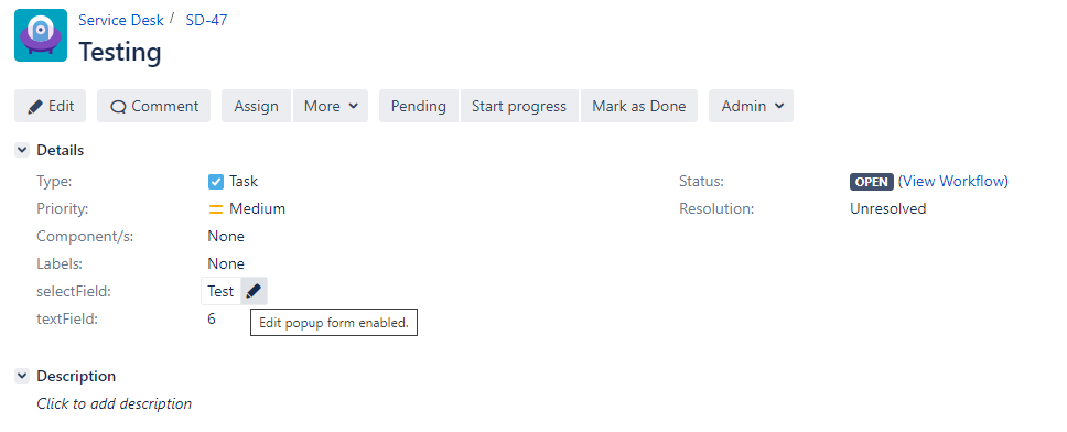

Mathis Hellensberg
July 1, 2020
Hmm wierd. Works fine here. I see the edit if i hover over the field, but i can't actually edit it..

Alejandro Suárez García
Atlassian Partner
July 2, 2020
@Mathis Hellensberg you only have to add the field in the behaviour. That forces the edit screen to pop up when you try to inline edit it.
