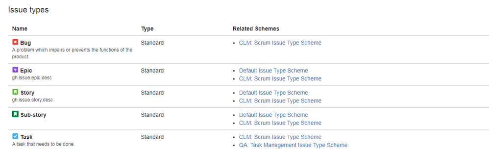

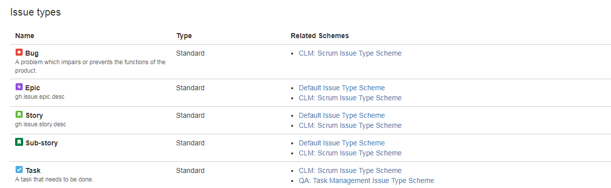

Can you please help me with script of the below use-case –
For a sub-story which is linked to a story.
I want to calculate the sum of the values of a custom field (Technical Points) belonging to issuetype – Sub-story. Further, I want that value to be placed in another custom field (Aggregate Technical Points) belonging to a custom issuetype - story. Attached screenshots display different
Attached screenshots display different issuetypes (Story and Sub-story) that we are using, just to avoid confusions.
Please help me with the script of the above use-case.Screen Shot 08-22-17 at 05.48 PM.PNG

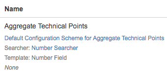

Joshua Yamdogo @ Adaptavist
August 31, 2017
You should also make sure that the Template for the Scripted Field is set to "Number Field" and that the Searcher is set to "Number Searcher".

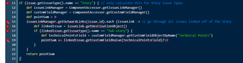

Swapnil Tiwari
September 4, 2017
Hi Joshua,
The query is giving me the error.
It says "The variable issue is not declared"
Please help
Thank you,
Swapnil Tiwari
Daniel Yelamos [Adaptavist]
September 4, 2017
Hi Swapnill.
That is an inline error, not a compilation error. The script could be working at compilation time. Could you save the script regardless and try to see if the script works?
