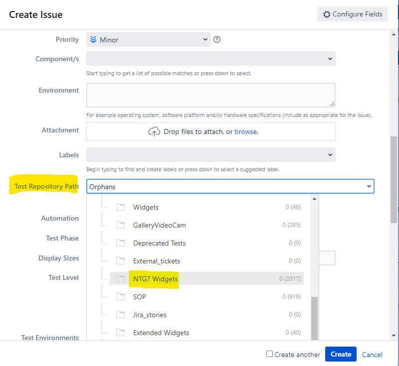

Hi,
I need suggestions for a ScriptRunner behaviour for the below condition which is based on the value of Xray "Test Repository Path"
WHEN the "Test Repository Path" is "NTG7 Widgets"
THEN the custom fields "Review" and "Review Comments" should be made mandatory.
Any help here is highly appreciated.
Thanks in advance,
Venkat
