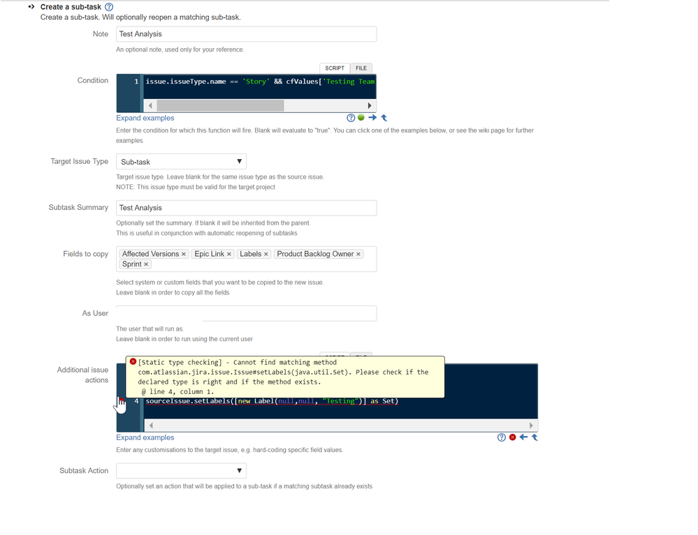

@Mark Markov im getting the following error, and when i've executed it, it doesnt change the parent label:
Mark Markov
August 8, 2018
Oh, it is not mutable object. This should work.
import com.atlassian.jira.issue.MutableIssue
import com.atlassian.jira.issue.label.Label
issue.setLabels([new Label(null,null, "Testing")] as Set)
((MutableIssue) sourceIssue).setLabels([new Label(null,null, "Testing")] as Set)

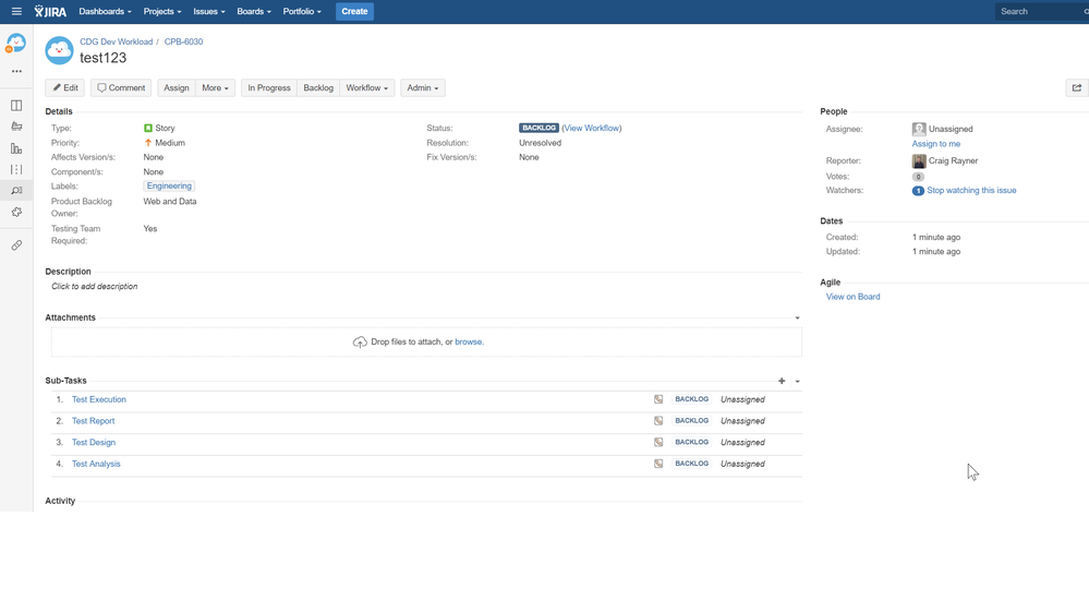

@[deleted] I have executed using the code above but it still doesn't set the label to Testing in the parent issue. This is post execution, it sets all the subtasks correctly to 'testing', but not the parent.
Mark Markov
August 8, 2018
Forgot to update source issue :)

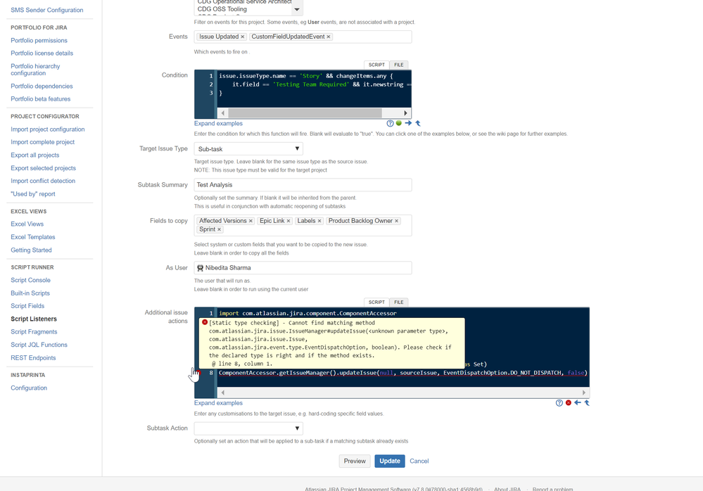

@Mark Markov apologies for pestering you. With that code im getting an error on the last line, also tried executing and it still didnt add the label to the parent:

Mark Markov
August 9, 2018
This should work
import com.atlassian.jira.component.ComponentAccessor
import com.atlassian.jira.event.type.EventDispatchOption
def issueManager = ComponentAccessor.getIssueManager()
def parentIssue = issueManager.getIssueObject(sourceIssue.getKey())
parentIssue.setLabels([new Label(null,null, "Testing")] as Set)
issueManager.updateIssue(null, parentIssue, EventDispatchOption.DO_NOT_DISPATCH, false)

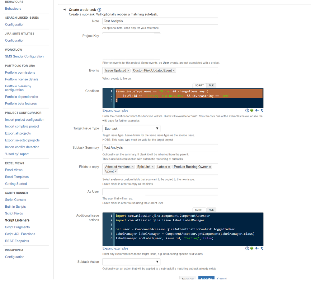

For a bit of background - My listener will create a subtask using the following code when a custom field value "Testing team required" is set to Yes. This will then create a subtask.
issue.issueType.name == 'Story' && changeItems.any {
it.field == 'Testing Team Required' && it.newstring == "Yes"
I've added the code you pasted to the 'Additional issue actions' but now the whole listener is failing with the above error

@Alexey Matveev this is what im trying to do
Alexey Matveev
August 8, 2018
It will not work. Issue does not exist yet, when additional issue action is executed.

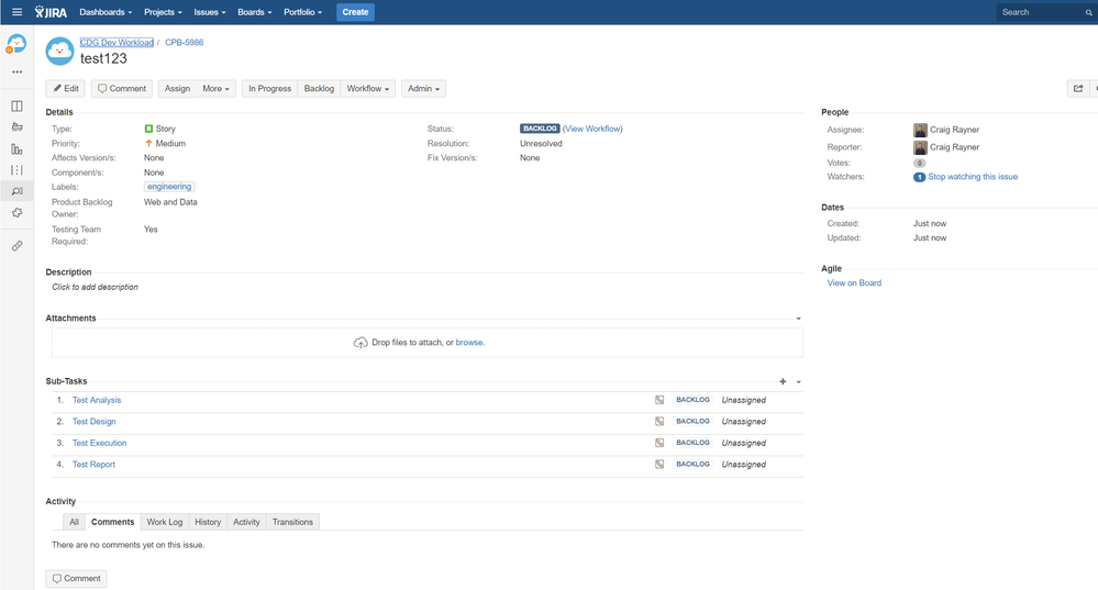

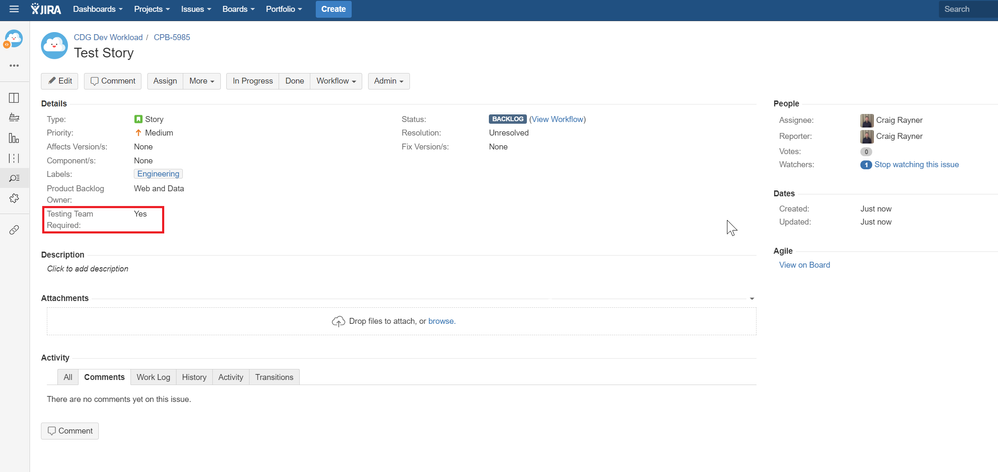

@Alexey Matveev it does exist. I've got a story already, where my testing team required flag is set to no. When i set it to yes it creates a subtask, and when i set it to no it deletes the subtask it created. So i need this to work for existing story's where no subtask currently exists, and when yes it clicked, it creates the subtask with the label "testing".
Currently, if i remove the code i've added, and set the flag from no to yes, it will add the subtasks i want (as below)
