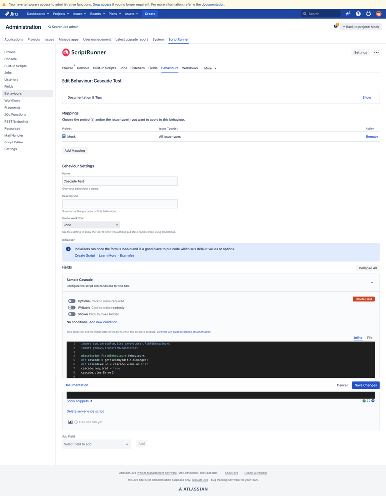

Below is a screenshot of the Server-Side Behaviour configuration:-

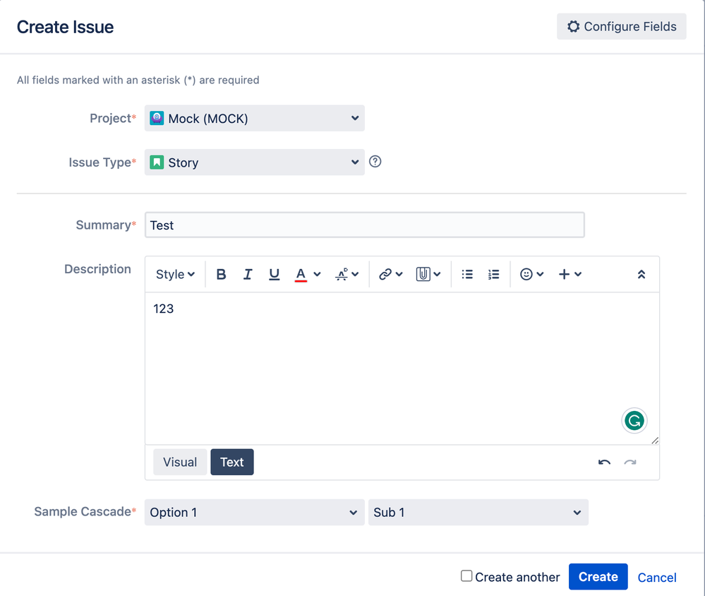

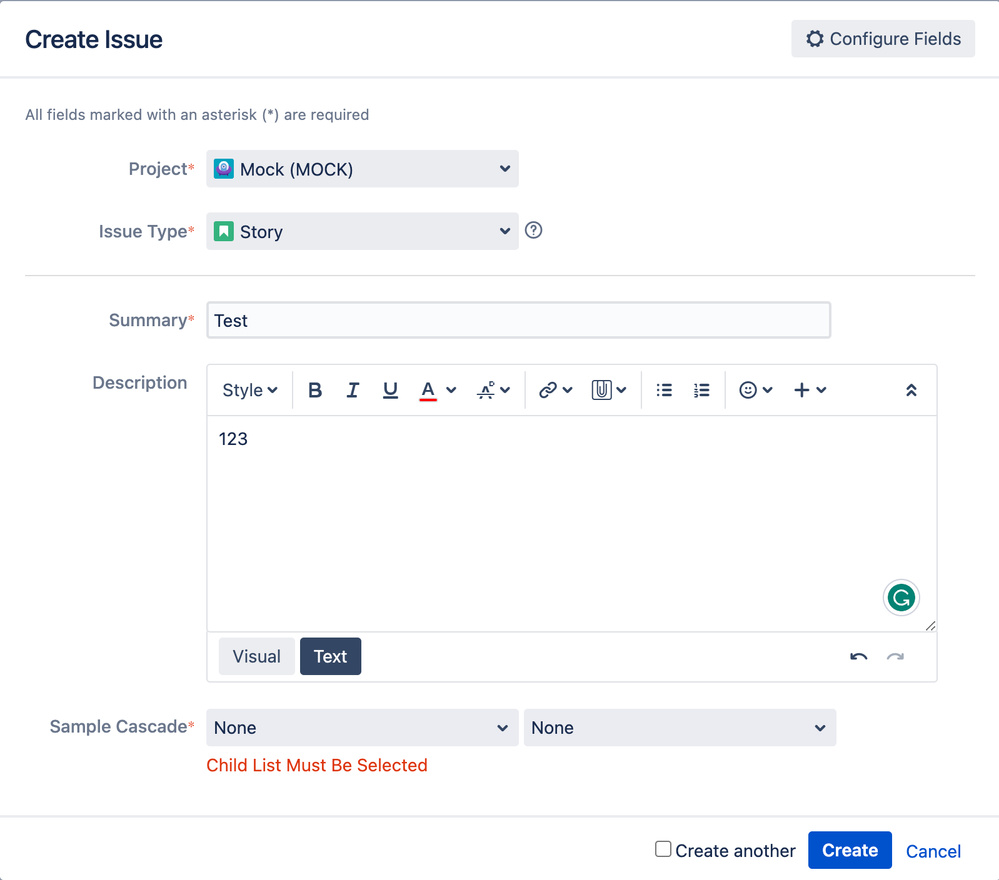

1. When the Creat dialog is first loaded, the Cascading List will return an error message as no value has been set, as shown in the image below:-
2. If only the parent value of the Cascading List is selected, as expected, the error message will not be removed as shown in the screenshot below:-
3. Only once the parent and child list options are selected from the Cascading List, will the error message be removed as shown in the screenshot below:-
