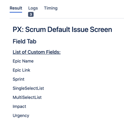

I came up with the script below that you can run in ScriptRunner's Script Console.
What it does is that it gets all the custom fields for all issue types of the project & then compare them with all the fields (system + custom fields) on every screen (whether the screens are applied to the workflow transition or not), then return only the custom fields as the final output.

You can of course tailor this script to your requirements.
.getCustomFieldObjects() method allows you to specify the issue type of interest. Some of the transitions in your workflow may not have a transition screen. If you know the exact screen id that you're looking at, you may change the fieldScreens.each iteration (keep the code block) to:
//10000 is my screen id
def fieldScreen = fieldScreenManager.getFieldScreen(Long.parseLong("10000"))
if (fieldScreen) {
//code block
and you'll get the custom fields that present on a specific screen.
I hope that this helps!
