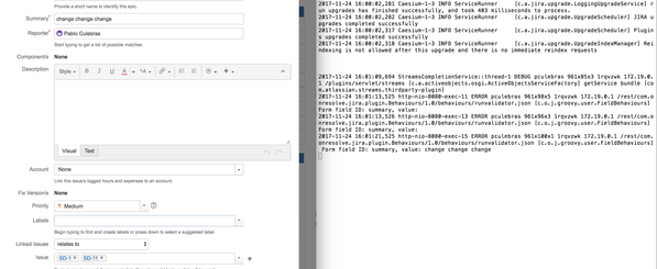

Here you may see the config:
Here the results:Screen Shot 2017-11-24 at 17.01.50.png

I am not able to reproduce the bug. I just added a behaviour to the "Linked Issues" field, added a server-side script that has a logging statement, and started changing the Linked Issues field on the create screen. As expected, I get this in the logs:
2017-12-04 15:14:58,950 http-bio-8080-exec-11 DEBUG admin [jira.groovy.user.FieldBehaviours] Field changed
2017-12-04 15:15:06,745 http-bio-8080-exec-11 DEBUG admin [jira.groovy.user.FieldBehaviours] Field changed
2017-12-04 15:15:08,408 http-bio-8080-exec-11 DEBUG admin [jira.groovy.user.FieldBehaviours] Field changed
I am running ScriptRunner for Jira Server, version 5.2.3. Jira version 7.6.0.

This is what I detected by playing with the browser console:
- It seems that posting runvalid method does not trigger for the field Linked Issues, whereas it does for any other (not binded correctly on startup?).
If I manually edit and send the POST request to the runvalidator.json endpoint, the change is captured by the serverside script and it generates a log entry.
P.S.: I am not using any Ad-blocker add-ons.
