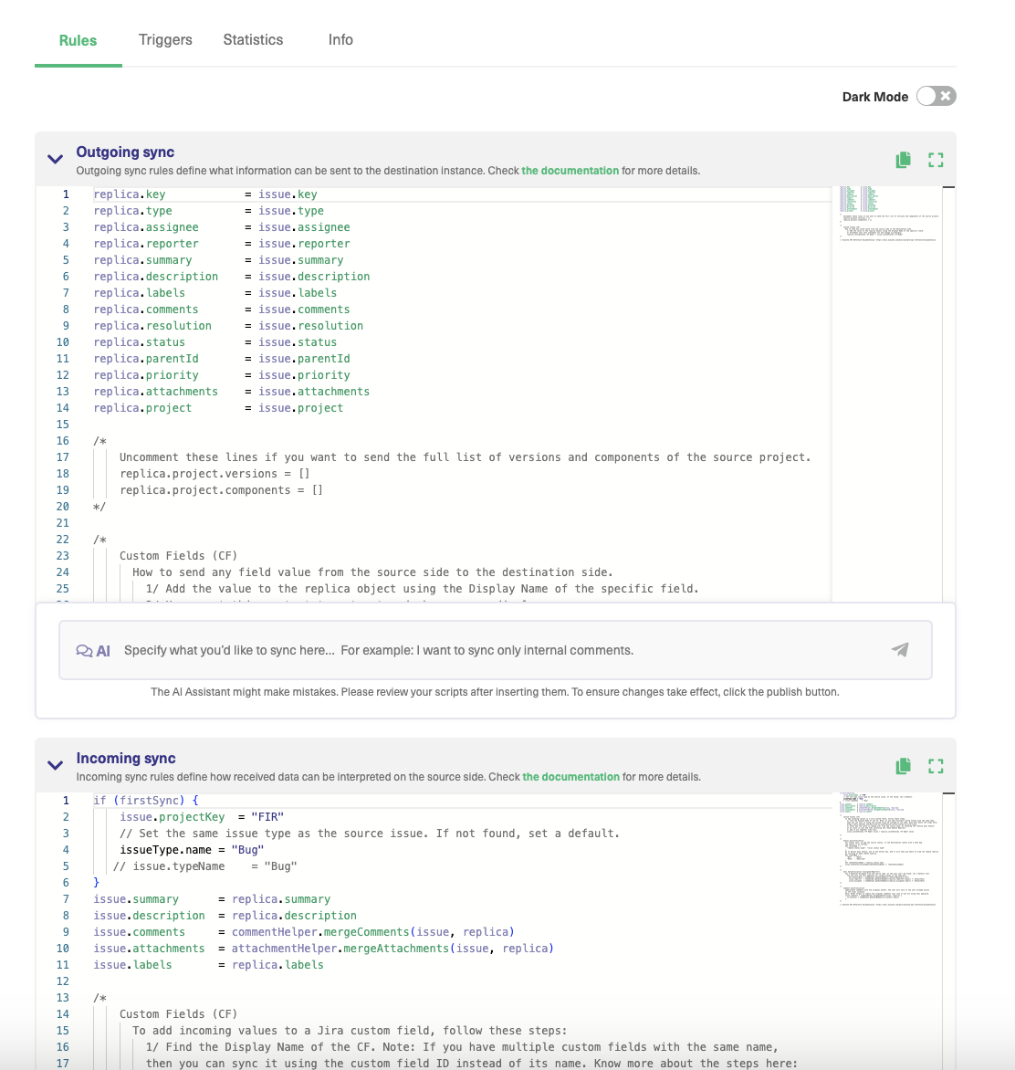

Once connected, click Configure Sync and navigate to the Rules tab, where you’ll set up sync rules.
In the Rules tab, you’ll find default scripts for syncing basic fields like summary, description, comments, and attachments. To sync custom fields or behaviors, you’ll need to add your own scripts.
The Rules tab is divided into:
  • Outgoing Sync: Defines the information sent from Jira to Azure DevOps.
  • Incoming Sync: Maps the information received from Azure DevOps into Jira.
The same exists on the Azure DevOps side.
