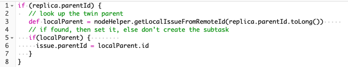

Whenever a subtask is synchronized, it is important to sync the relation with the parent of the subtask
This can be done by adding the parent id of the subtask to the message that will be sent to the other side:
replica.parentId = issue.parentId
On the receiving end, it is important to ensure that the subtask parent is mapped to the right parent.
Following code-snippet allows doing so
The code snippet is also valid in case the subtask is moved from one parent to another on the source.
The message (replica) will contain the new parentId, and if the parent is found, twin subtask will be moved to the new parent.
