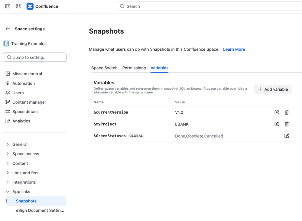

In Snapshots, a variable is defined centrally, at space or site level, and referenced from a snapshot's configuration instead of a hard-coded value. Call it something like myLatestVersion and set it to whatever you are testing now. Then reference it in two places: the filter that selects the tests, and the Fixed version filter of the test run level. When your team moves on, you change that one value and every report built on it follows.

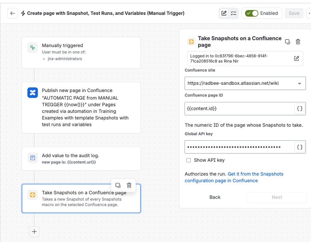

This is the Atlassian-admin part, and it takes a minute. A Confluence administrator opens the Snapshots configuration, goes to the Automation tab, makes sure automation is allowed, and generates a global API key. Keep it somewhere your automation rule can read.

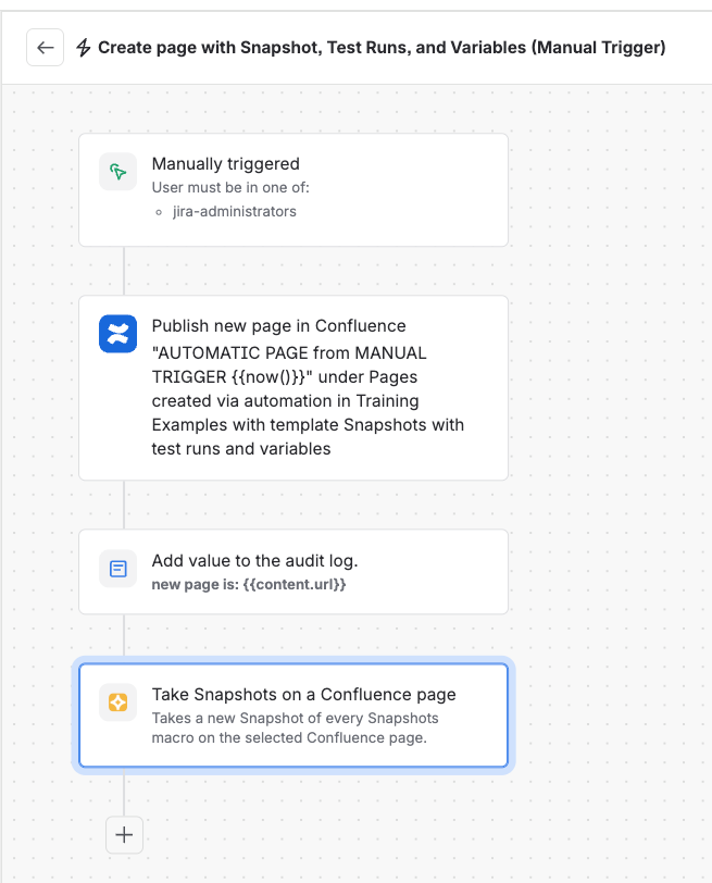

The rule has four steps:
  • Trigger. Start with a manual trigger while you are testing the rule. Once it works, tie it to
something real: a test plan transitioning to closed, or whatever event in your process means the testing is done and the report should exist.

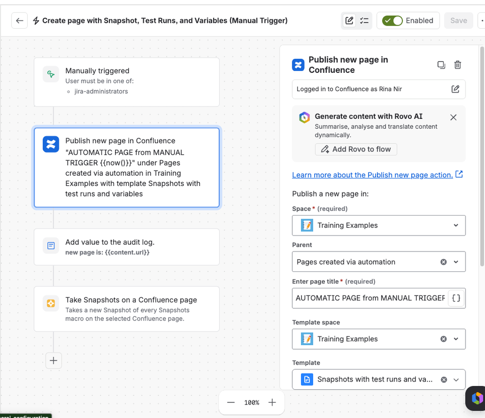

  • Create the page with Confluence's own publish new page action, selecting your template.
  • Log a message containing a reference to the new page. Optional. You will want it the first
time something goes wrong.
  • Take the snapshots, using the content ID of the page created a moment earlier and the global
API key. This is the step that turns an empty template into a report.

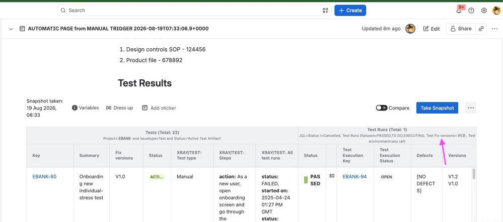

Trigger the rule and a page appears, structured the way your organisation expects, populated with the tests and runs for your current version, readable by anyone with Confluence access.
Roll to the next version by changing the variable. The rule, the template and the structure all stay as they are.
