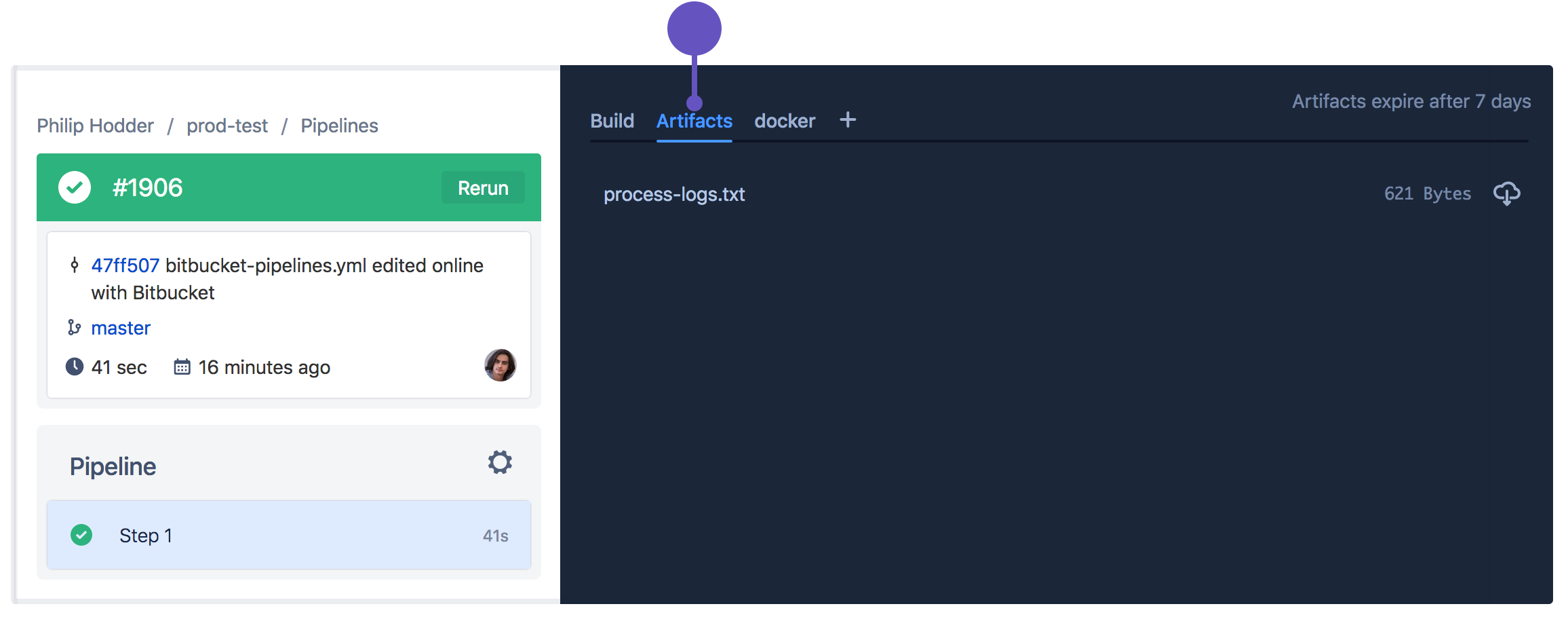

For example you can get a snapshot of what processes are running in your pipeline by adding the lines below to your bitbucket-pipelines.yml. This is useful if you’re trying to see if a process has hung or is using too much memory.

Once the pipeline step completes, you can download the artifact from the Artifacts tab on the Result Page.
