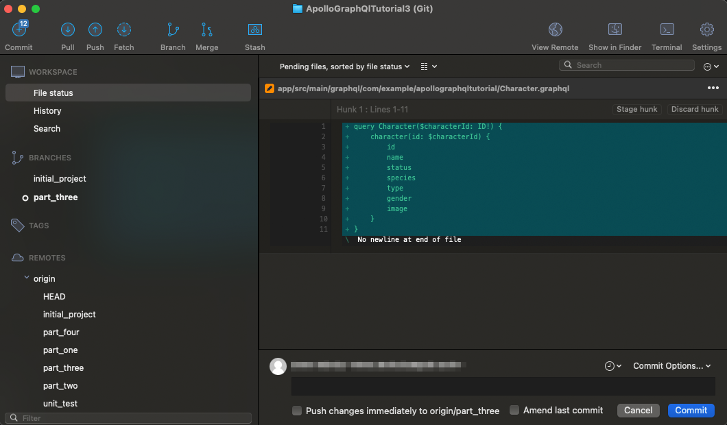

I work with SourceTree for a few years now and never had problems with it, but suddenly I can't see my files I added or changed for the next commit.
My Sourcetree looks like this:
And I want it like this, with the "Staged files" list on the left side
I hope anyone can help me out here!

Edit: I already tried to reinstall and I checked every option I could find but nothing changed it back to the original layout
Well, I've exzessively switched between projects and suddenly there was a small gap between the Branches and Committed files View, so I just dragged it to the side and there it is!
Would love to see an option in the "View" Section to open or close this part of the UI as i must have accidentally dragged it fully to the left side. I even tried before to drag the line to the right but couldn't open it again.
I had the same problem, but in the other way. I could only see the file list and not the diff. Your suggestion helped and I was able to find the drag handle and get the diff view back.
