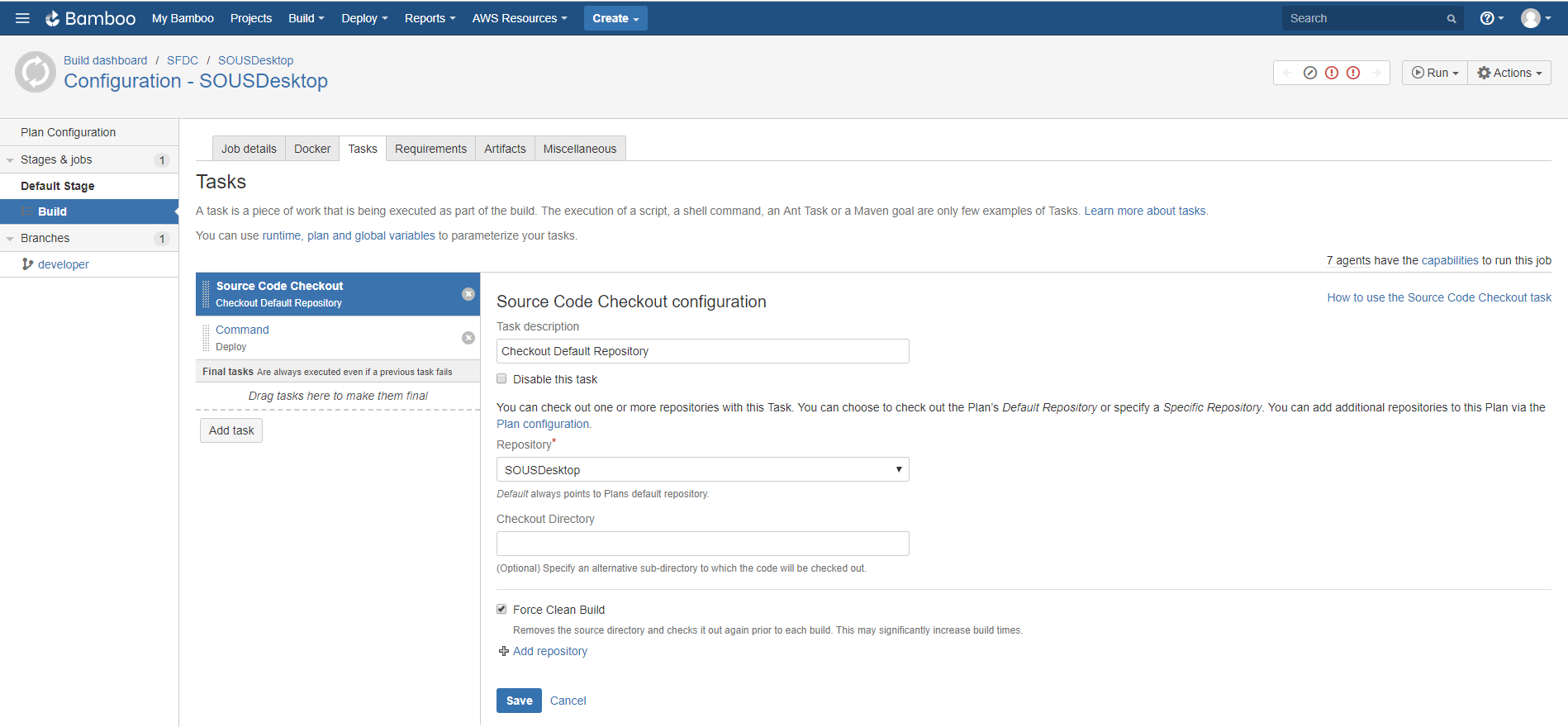

The Bamboo build is setup to check out a repository, then run a task called deploy:
It looks like the issue may be happening when checking out the repository (I am completely new to Gradle, so would be happy to even have this validated/refuted). One other thing to note is that in the build.gradle file, I have Bitbucket creds, but I intentionally switched bewteen invalid credentials and working credentials, and the output was the same - so I'm thinking it's not something specific to this repository itself.
