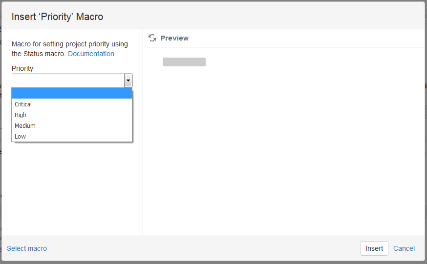

Defining the UI
Since the goal of this wrapper macro is to restrict the options to a defined set, we want the user to only be able to select from one of the defined priorities (the associated color will be set in macro code). The needed macro code for creating a pull-down with a set number of conditions is:
## @param Priority:title=Priority|type=enum|enumValues=Critical,High,Medium,Low
Note: There should be no spaces in the list of enumerated values. In other words, "Critical" is different from "Critical ". For details on user macro syntax, see User Macro Template Syntax.
