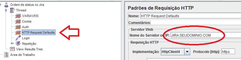

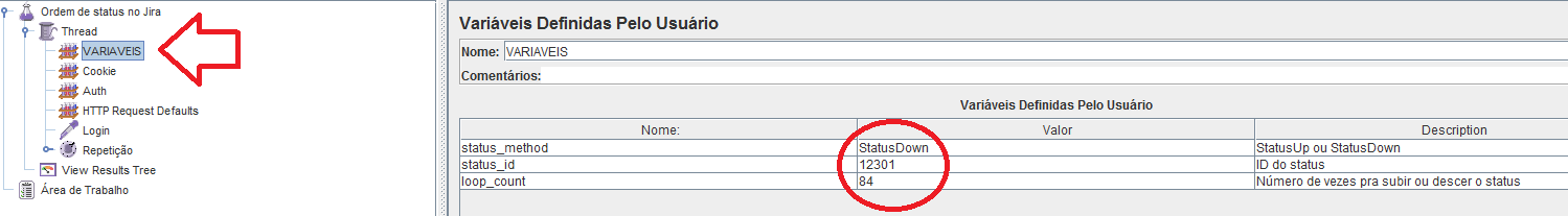

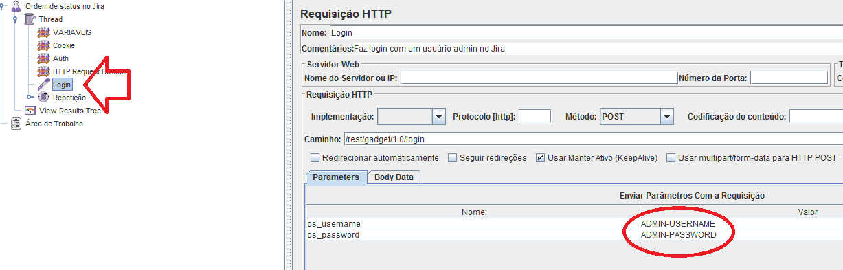

4) Open JMeter and open the newly created file. Edit the settings like the prints below:
status_method: StatusUp or StatusDown (mopve up or down in the global order)
status_id: The ID you got in step 1).
loop_count: The number of positions you want to move the status up or down.
Hostnaem or IP: ex. jira.yourcompany.com
os_username: An Admin's username
os_password: The admin's password
