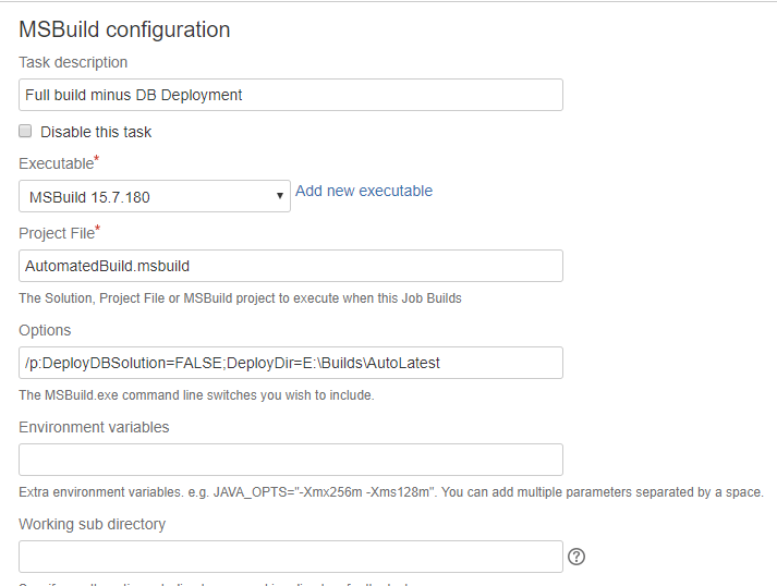

I have migrated the solution to .Net framework 4.7.2 on MSBuild 15 from .Net Framework 4.0 on MSBuild 10. The local compile time has not changed. I have then made the necessary changes (like changing the executable to MSBuild 15.7.180) with the following options; /p:DeployDBSolution=FALSE;DeployDir=E:\Builds\AutoLatest.

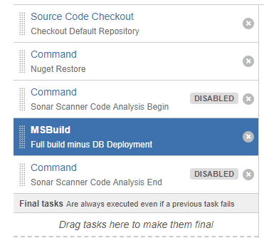

The build plan is as follows:
