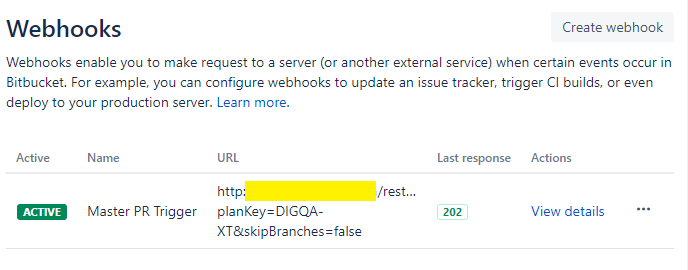

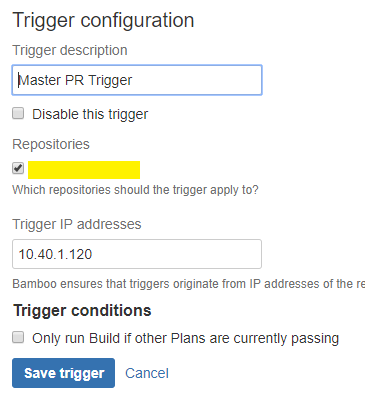

I'm new to bamboo and webhooks. I'm trying to start a bamboo build automatically when a PR to master branch from my repo is opened.
I followed this guide but the remote trigger is not starting at all.
Bamboo:
BitBucket:
I've already checked the following:
- verify that the whitelisted ip is correct (the bitbucket webhook fails if i remove that)
- my bamboo plan is enabled and is building fine on manual run

- name: Remote trigger
description: Master PR Trigger
pluginKey: com.atlassian.bamboo.triggers.atlassian-bamboo-triggers:remote
enabled: true
configuration:
repository.change.trigger.triggerIpAddress: 10.40.1.120
triggerConditions:
com.atlassian.bamboo.triggercondition.internal:plansGreenCondition:
enabled: 'false'
triggeringRepositories:
- 7818811903068661169

EDIT 1:
Okay, so I realized the hook and the trigger is actually working. I misunderstood the trigger setup on bamboo.
Current behavior:
- PR to master is opened
- BitBucket webhook (on PR) is fired
- Bamboo trigger is set to remote / bitbucket server repo. Because of this, the build will not start until the changes are commited / PR is actually merged
Problem: I want the build to trigger once the PR is opened (before merge). To a bit more context, this is the ideal flow of my build:
