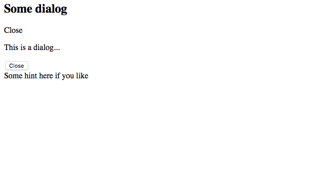

Something to note is that the full REST endpoint URL (e.g. https://<Confluence URL>/rest/scriptrunner/latest/custom/showDialog) is an address that users can hit directly in the browser. Granted, hitting the URL directly won't produce a nicely formatted dialog. Using the code from the above screenshot, hitting the REST endpoint URL directly produces the following webpage:
Please note that this is a page that exists outside of Confluence, meaning directing user traffic here won't impact the performance of the actual Confluence instance. Since HTML is ultimately returned at the end through:

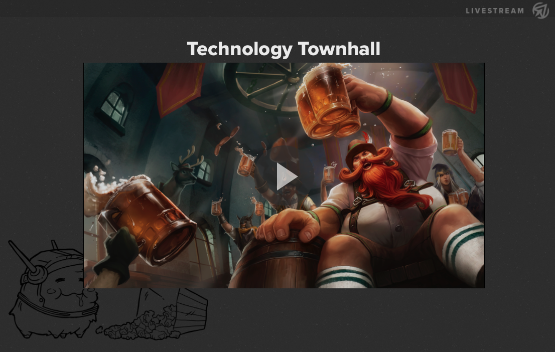

The content of the dialog variable can be a full HTML document with internal CSS within the <head> section. As for placing the livestream video, we utilized <iframe> tag inside the HTML code. As a result, we were able to produce this:

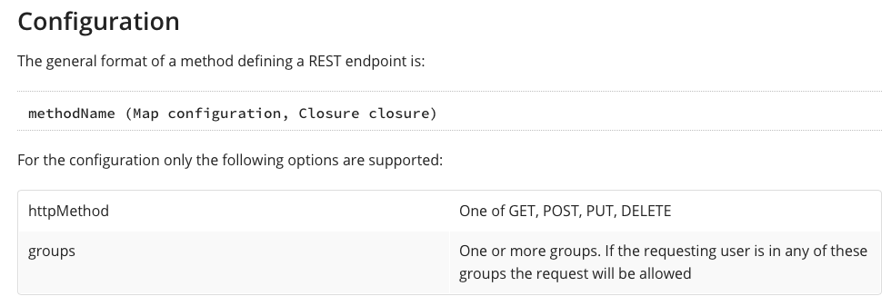

One powerful advantage of using a REST endpoint is that it's recyclable. For subsequent livestream events, we can just swap out the src value within the <iframe> tag. The downside is that REST endpoints bypass login; anyone who has the knowledge of the REST endpoint URL can access the page without logging in to Confluence. Even if your Confluence instance is behind a firewall, this posesproposes some security concerns. Fortunately, you can declare a groups attribute when creating the REST endpoint, as shown in the ScriptRunner for documentation:
This forces users to log in to Confluence before being able to hit the REST endpoint. In Riot's case, we sent out a company-wide notice to direct users to a Confluence page that contained the link to the livestream page. By doing so, the AD group information of the user was captured at login, and the REST endpoint checked whether the user belonged in the group specified in the groups attribute.
