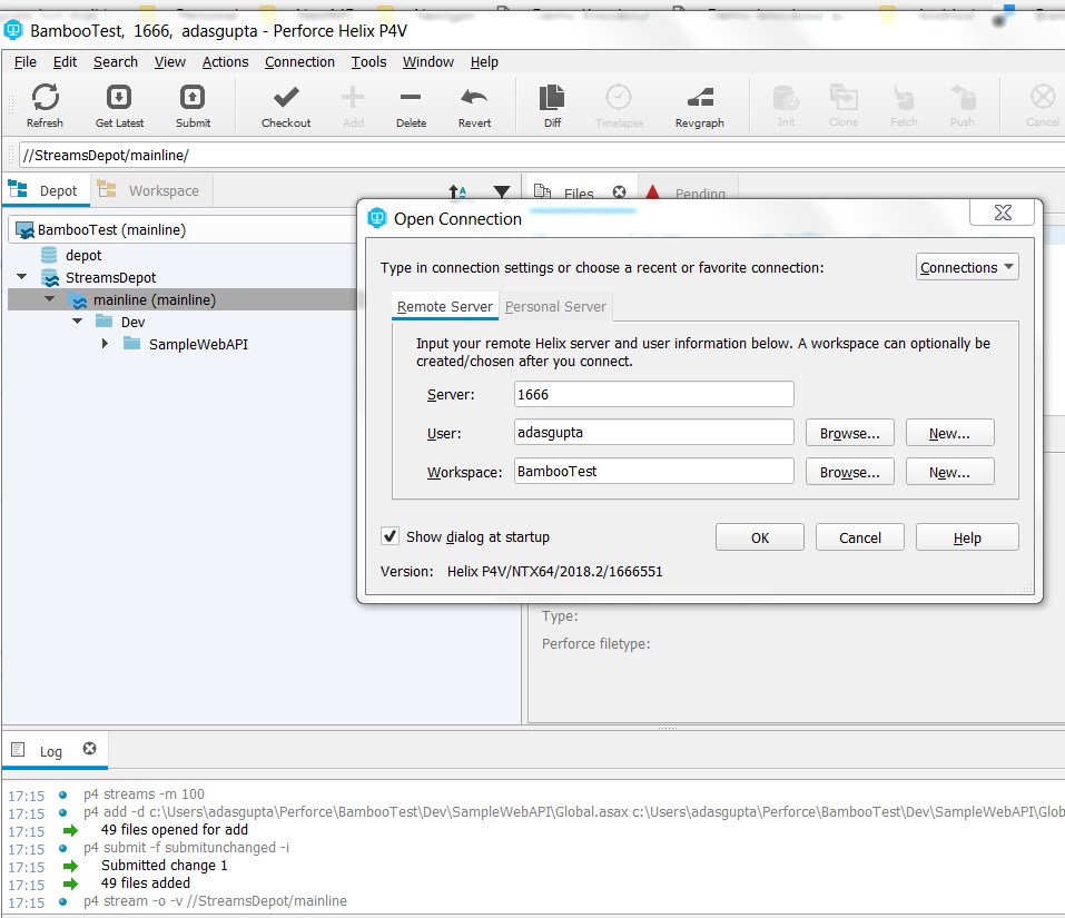

I have Downloaded and installed latest P4D and P4V from https://www.perforce.com/downloads and installed in the same machine. Perforce server and client are correctly configured as I am able to checkin source code to server using client. Running on port 1666. By client and server are both installed in C:\Program Files\Perforce.

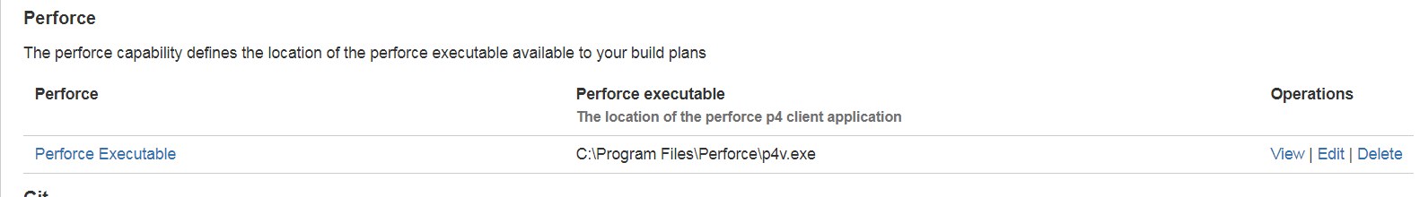

I have added bamboo Server Capabilities for perforce.

User id and password are correct also url with port is correct. I am able to get data from repository with this detail.

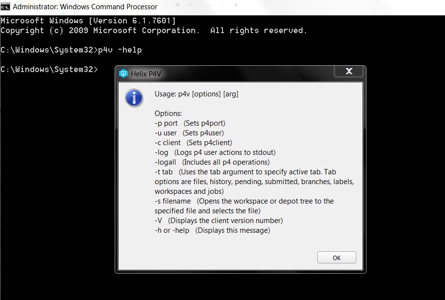

p4v.exe is already there in my PATH and also I run p4v -help on command prompt, getting following result. I dont see any option named 'info'.
