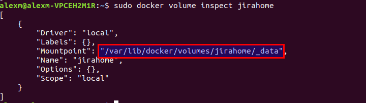

you can see, where the created volume is in your file system, with the following command:
docker volume inspect jirahome
The output will be like this:
