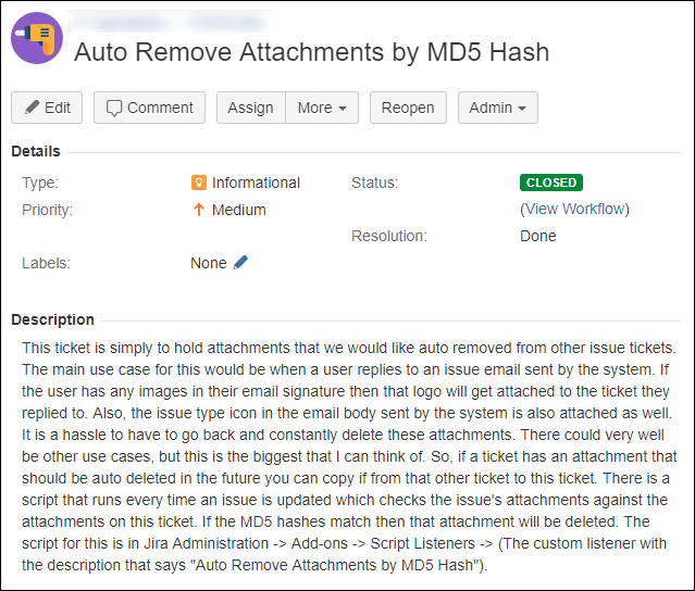

So, I need to make it easy for others than myself to help maintain. Maybe if I made a way for my colleagues to take an attachment from an issue ticket and simply drop to a centralized storage location that could be scanned by the script … yeah that could work. It involves no knowledge of MD5 hashes or scripting and should be easy for pretty much anyone to do.
Now if I only had a location where we could place these attachments. A place that JIRA is able to scan. A place that all my colleagues have easy access to. If only such a place actually existed … hmm … oh, wait!! I could just have them attach the files to another JIRA ticket that will be used as a control ticket of sorts. Any attachments attached to this ticket would be compared against by the script and if a match is found then the issue attachment is deleted. (insert Handel’s Messiah playing in my head here)
The great thing is that most of my script doesn’t really need to be changed. All I need to do is specify a control ticket key in the script and have the script build the list of hashes based on that ticket. Here is my ticket …
And here is the new script. I’ve cleaned it up a little from the last version and removed a call to a method that is currently set as deprecated. It still worked even with the call, but best to get rid of that call before Atlassian removes the method altogether. Simply replace “{Project Key}-{Issue Number}” on line 12 with the issue key that holds your attachments to remove. So, if for instance the issue is in the FOO project and the issue number is 789 then that line would look like this …
